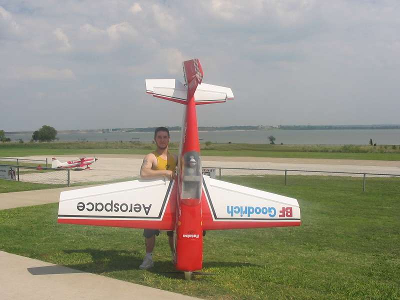

My Hurley with a 3w-106.....had a bme 100 bought for the plane until I found out the engine was way too light for the airplane.
I have two Hitec 5945s for the elevators and a dig 805 for the rudder under the canopy. Has a mezlik 27x10 and has unlimited vertical. Original landing gear was weak and had TNT build me a thicker one. Thats my army son is holding plane.
