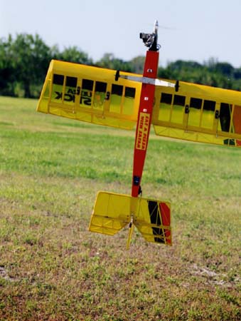

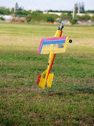

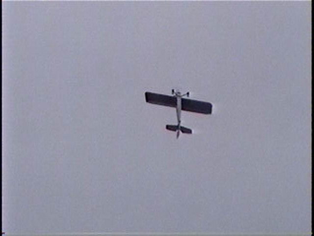

APC 16x4W
OS 120III

ORIGINAL: Johnnylightning
APC 16x4W
OS 120III
16x4 sounds a little lite, what's the peak RPM.

ORIGINAL: rcflier_gi
Never checked it...just put it on and it worked.

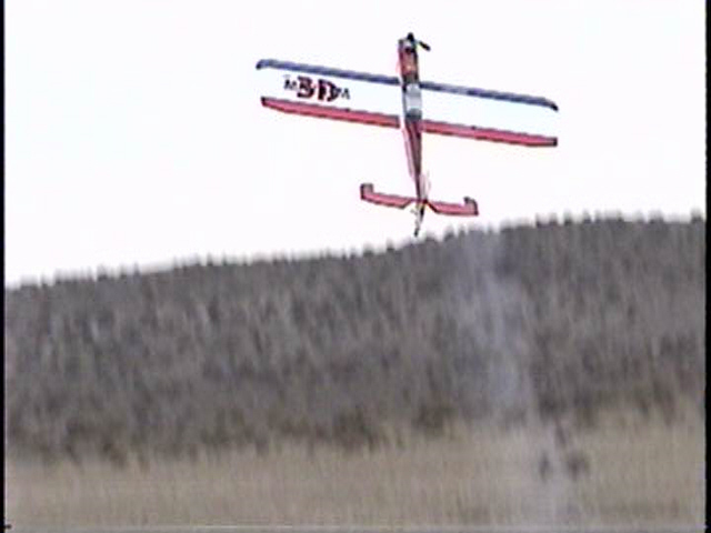

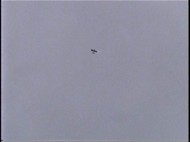

YS 1.20 AC, APC 17x6, pulls 8.5lb SIG 3D Mayhem like a locomotive and thats at 5500 ft elevation.

he said it was an OS not a ys...big difference
17/6 apc is too much prop for os 120

Ya, yer right, big difference. But I was talking to puffstatler, he has a YS
Dokey-as far as the OS 1.20, go with a 16x4W if it can handle it, my YS .91 can!
I love power
Im just kiding around, but seriously try the APC 16x4W, I guarantee you'll love it
