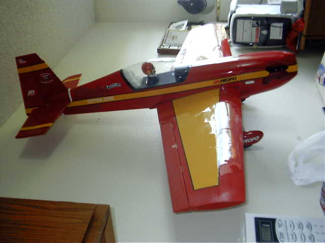

Default GP Extra 300s 60 size kit pic
Let me know what ya think.

Ahhhh, It's beautiful! I just retired mine after many great flights. What engine do you have in it? I had a YS 91AC and the plane went vertical forever! I may have to get another one someday.

Im using a Saito 100 and dual servos for elevator and 130 oz torque servo with pull pull on rudder and sullivan tail wheel.

That pic took me a while to figure out! I was looking at the other stuff in the pic and everything seemed wrong. Then I noticed that the celing in the wall on the left and that the plane is hanging from the wall and the picture is turned! TRICKY!

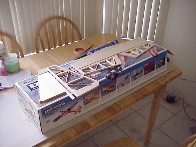

Default Here is my GP Extra 300 (60 Size)
Well the tail is complete. I enlarged the elevators by about an inch at the widest point. I just tapered it into the original size of the side of the elevators. The rudder also has has about an inch added to it at the base of the rudder. Like the elevators it is just tapered into the original size at the top.
Its getting there!
