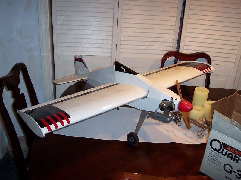

Hi, Any thoughts on making this plane fly 3-D. Its very quick with a 10/6 prop with a .40 engine. Will changing the prop(sugestions please)and oversized elevator,and rudder,give me more of a 3D performance.I know I can go out and buy a plane but I like making stuff work.
Any help will be appreciated. Brad

I know the feeling of "Making things work" but to be honest I think you might be better off with getting a 3D machine designed for that from the ground up.
If you want to try to make it work them go with less pitch and more diameter. Like a 12-4 or the APC 12.25-3.75. Move the CG back farther, by all means enlarge the elevator and rudder, Ailerons if possible.

To drop that engine into, I would say a profile like an Extreme 330, Extreme Flight .40 size Edge 540T (or any 3D profile) or a twist3D or something but its still going to be sortof a small engine.
