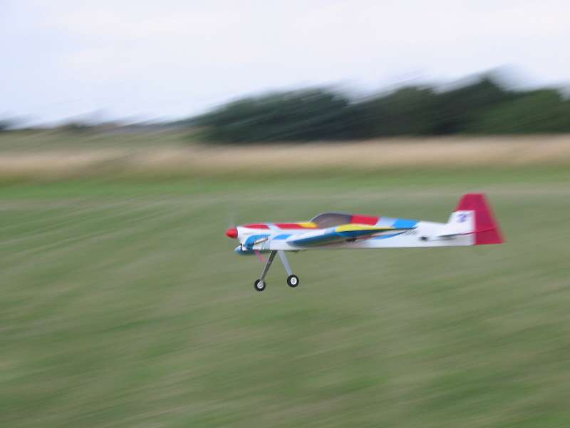

wow this plane is very nice to fly i took it up today and it flew very good dint do that much with it as i got a new engine in it and it dint sound on song, i well be taking it down again tomorrow to see what it it can do.!!!!

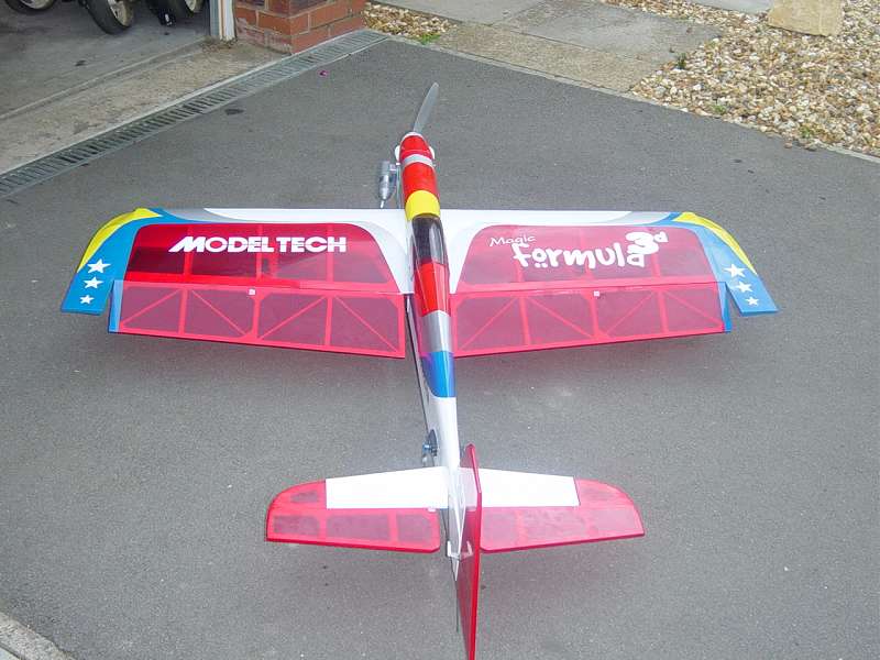

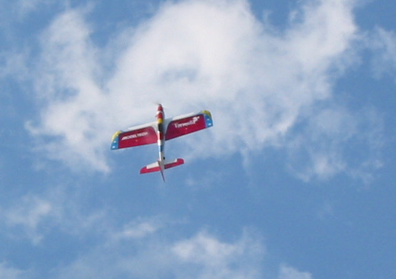

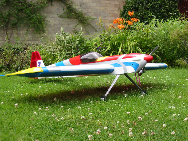

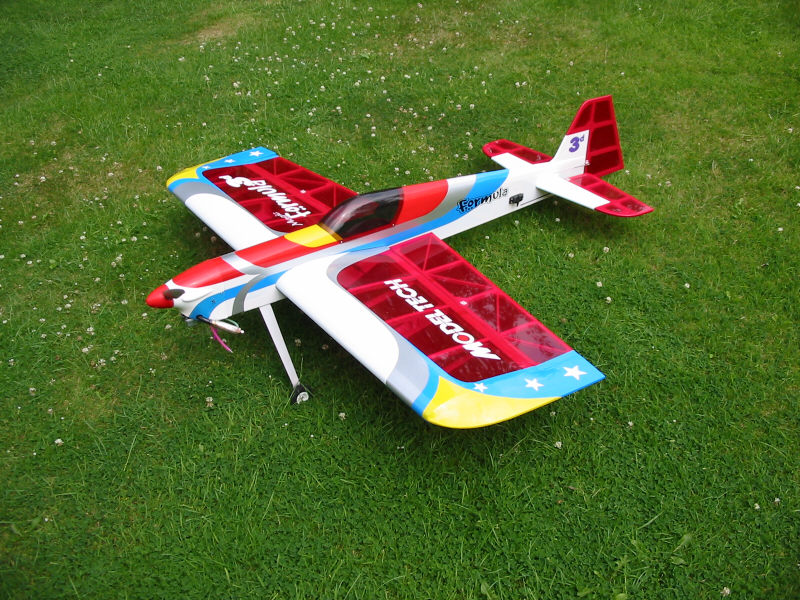

Guys Hi,
Formulas first outing this weekend, it is great. With the CG at 110mm, the inverted flight is achieved by breathing on down elevator- perfect. Shes a real floater, mine is 6lbs, 2oz when all said and done, messing with lead etc. The only thing I will change is to fit a aluminim mount for the saito 72, the plastic one supplied is "giving" a little in the hot weather. No flutter porblems with mine, I used proper hinges and carbon sleaved the pushrods, I would imagine a 91 would be awesome.
See piccies
See piccies
