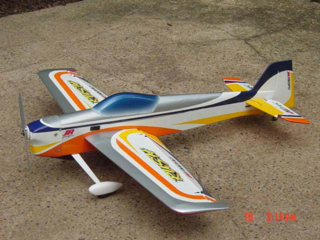

Freestyle Rush....Does Everything....Why buy a big plane??? VIDS
Here are some vids of my YT International Freestyle Rush. Does everything a big plane does in a .40 size plane. Puts my Funtana to shame. NO WING ROCK in an elevator. Check it out!

built the Rush in 2 evenings and had it ready to fly on the third day. I am using an O.S. 50 SX, 13-4 APC(not the wide blade though) and 20% fuel. I used all the stock hardware with the only modification being that I installed the rudder servo in the tail and abandoned the pull-pull. In retrospect, it might have been better to install the elevator servo in the tail as well, as I still needed to add 2 ozs of lead to the tail to achieve the tail heaviness I needed for 3D. The recomended CG is 110mm back. I balanced mine at about 125 or about 5 inches back for the first flight. It required quite a lot of rudder to knife edge, would not flat spin, and would not do a wall. I added 2 ozs to the tail and it is now perfect! I am now balanced at 5.5 inches back or 140mm. I think between 5.5-6 inches is the ideal and will be moving mine back just a hair more to get it to really "pop" up in a wall. Amazing that no matter how much I move the CG back, it never gets touchy on the elevator and lands just as easily. I Hardy have to breath on the rudder for knife edge, walls are better, waterfalls are end over end, inverted is almost hands off, slow rolls and point rolls are effortless, and flat spins and blenders are easier. The weight also helped with harriers. With about an inch of up aileron mixed to the elevator, this is one of the most stable planes in a harrier I have flown...........and its only a .40 size plane!! Very easy to hover and torque roll I have 60 degrees elevator travel, 50 on rudder, and 30 on the ailerons and 50% Expo on all surfaces. Basically this plane has the 3D capabilties and handling of a foamy but precision qualities of a pattern plane. It flips around like my little foamies but then does a 4-point roll like a 2 meter pattern plane. I couldn't have asked for a better combination.
Now flying with a Saito 82 and 14-6. Better for 3D but the 50 was better at pattern stuff.

I got mine from Cheetahrc.com in the US. I think it was like $180-90.
I do have spoileron mixing in it. Its a little less than an inch of up flap mixed with up elevator and down flap with down elevator. With this set up, harriers are mre stable that my 33%ers. Also I am 2 inches behind the CG which helps. I don't have anything else going on thats out of the ordinary.

664kix,
Yes sir, Tumbler is a.k.a. HOLLYWOOD! haha. How did you know that. I have known Kohler for a few yrs. We fly at the same field.
JuniorPilot,
I can tell you what servos I am using but mine are total overkill. I have JR 4721's on the rudder and elevator. Waaaaaaay more than you need. Because I fly mostly giant scale and have mostly high torque servos laying around. The ailerons have Standard Hitecs.
I am using a HS-81 micro on throttle. I have another Rush on order for a backup and I am just going to use Hitec 605's all the way around. I have a 2 cell 200 lithium and 6V regulator for the battery and get 20 flights safely...........thats sick i know....haha.
