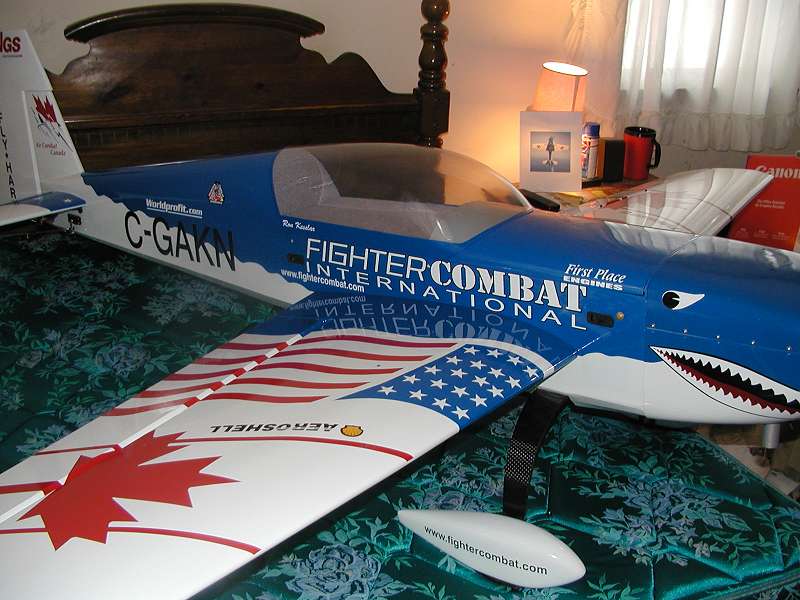

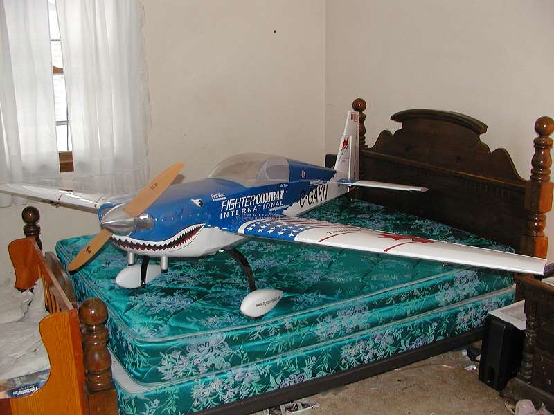

Here are a couple photos of the finished airplane. I have always liked the Fighter Combat scheme so now I have one. To bad its winter here[:@] so if you notice I'm putting it to "bed" until spring. Finished weight is 26Lbs 2oz not bad! When the weather is better I'll post more pics.

Looks awesome! I see you split the cowl too.
