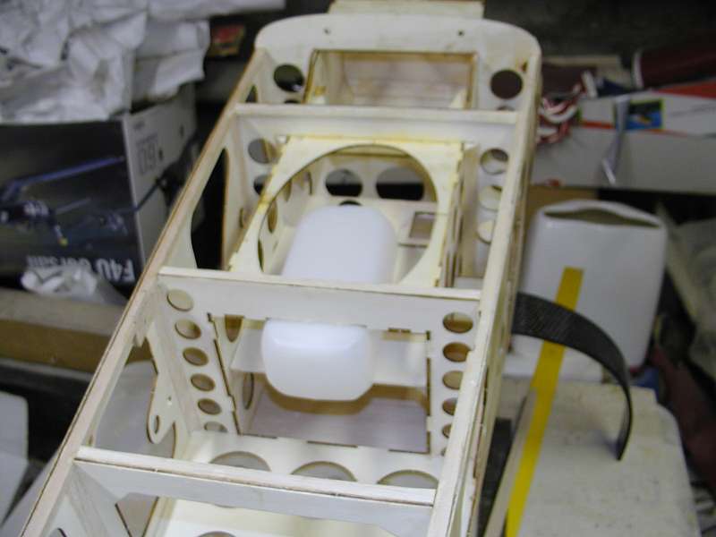

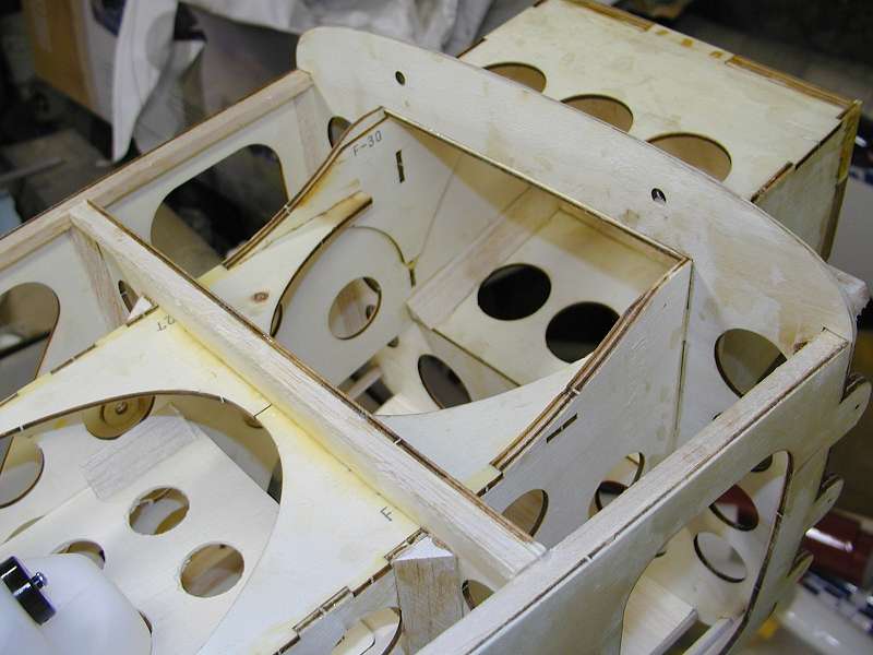

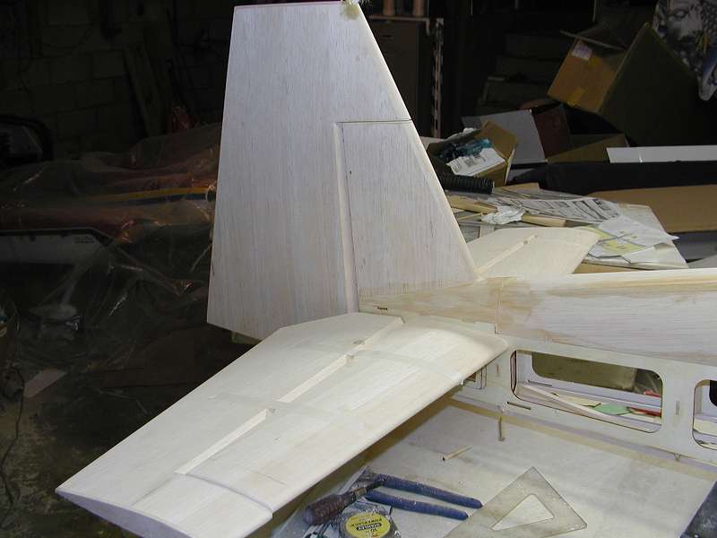

Here are some pic's. In picture 2 it looks like there are two servo holes but the bottom is for a rudder servo the top is a servo wire access hole. BTW this is one lite airplane!

More Pic's

And I thought my building space was cluttered!!
How about a picture or two of that engine?

Thats what happens when your work area is in the basement. My garage is of limits! For some reason my wife thinks I'll get dust all over, What's she thinking? It would help if I would put my tools back and quit being a Pack Rat! Oh well its my little world and the family leaves me alone! BTW I'm building a Carden Extra also. Could not make up my mind so I decided to build both. The Carden is wayyyyyyyy more work.

I am at the stage where I need to mount servos in my plane. Where did you guys install the elevator servo on the stab? Center of stab OR towards the inner side? I plan on using JR8611 per elevator half. I also plan to use single 8611 per ailerons installed in the center of the wing. Is a single 8611 good enough for the ailerons? The other option would be to install two 8411's per wing, and use the matchbox etc to match centers etc...too complicated basically...

Yes, they go in the stab. About 2" out from the center-edge of the stab and foreword is far as you want WITHOUT HITTING THE STAB TUBE jest clearing it is about right. As for one 8611, enough torque but its a large control surface, you are better off with two so they don't flutter. If you would use Hitec digitals no match box is needed if you know someone that has a programmer. Mount all the servo's front to back not that sideways thing[:-].

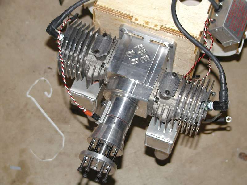

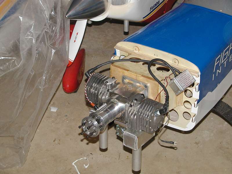

Here are some photo's of the FPE 6.8 (111cc) twin. Starting to line things up for mounting. This engine has 75 Lbs of thrust, that should be close to 3:1 WOW . It weighs 105 oz with mufflers and ignition.

ronk1,
Did you weigh the motor. Sig says the weight is 116 oz. Have you run this engine and how is the power?
