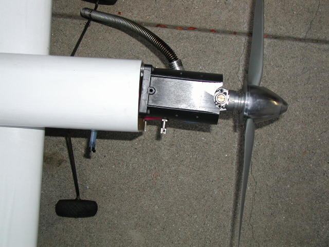

I just assembled the Extase in my garage. I think I had listed my CG as 7 - 7 1/4" behind the leading edge. Well, on an empty tank it was 7 3/4" behind the leading edge, about 1/4" in front of the foremost servo mounting cross fir strip. My incidences are 0 degrees for both wing and horizontal stab/elevator. I have attached a picture showing the right thrust in the engine (three washers behind engine mount on the left side mounts. I doubt I'll get to fly next weekend, since they have a comp. at my field, but I will add 1 oz of lead to the tail for next flight. My CG probably starts at 7 1/4" behind leading edge with a full tank, and ends at 7 3/4" at end of flight. I do feel a difference as the flight time progresses, but in no way does the plane become troublesome or even hard to land. It does start to show minor trates of tail heaviness at landings, but nothing bad.
Here is a picture of the right thrust and the engine mount offset on the firewall.

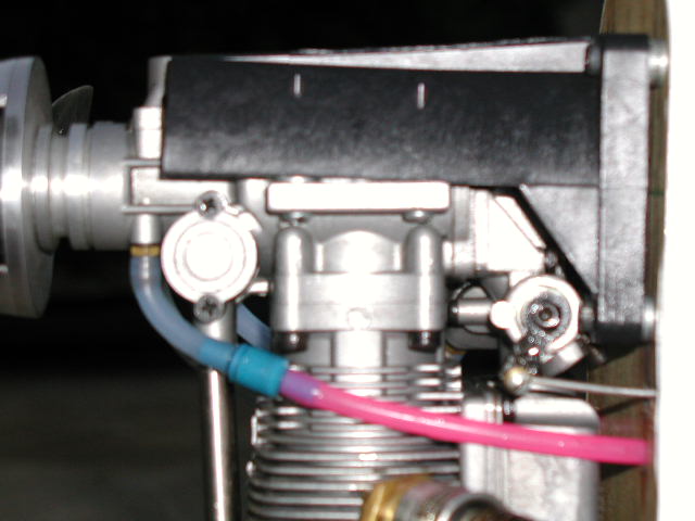

here is a picture of the down thrust I put in the engine. Just one washer under each forward engine mount lug. Not a whole lot, but enough for the plane not to lay over on its back when hovering he he. She requires very little down elevator to stay level inverted.

HI D, I have set up a few of these planes. Never with a YS though. Never used any down thrust. (0 degrees) Between 1.5 and 2.25 degrees of right thrust. I think by the looks of it, you might try using 2 washers, not 3.
I set the fuel tank as close to the CG as I could. Always kept the battery as far back as poss.
I also had never used a CG beyond 6.5" from the LE. @ the root.
This plane should do almost anything!! You are not getting the performance out of her. If the incidence are correct in the wings, must be in the set up some where?
Lets see if we can find her limits! Let me know. Good luck.
