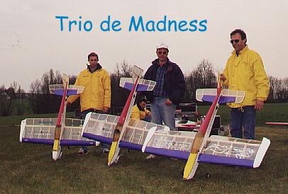

The madness. Check out www.rcaerosport.com for reviews and more pictures.

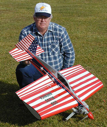

Don't let them scare you away for the Thunder Tiger Fun Tigers. They are a little heavier than you would expect and the covering is pretty bad (they do have an ARC). You need to re-enforce the ribs that hold the servo rails or the 1st heavy landing will break them loose.
HEAVY: OS FX .46 takes care of this -- put a Mac's Tune pipe on it and lookout.
