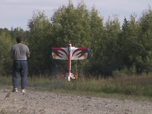

Default RE: UCANDO 46 - Which 2 Stroke?
fun_fly_3D,The Os 70FS will hover the UCD no problem,Its a slow pullout of the hover but accelerate pretty good.
my setup is
OS70FS
APC 14x4W
15% nitro
standard servo all arround except for rudder
weight 5.5 pound dry
C of G @ 5.5 inch
hope this helps
jeang
