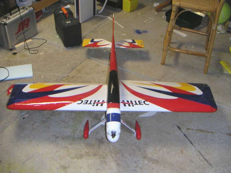

4-strokes are a must for 3d and tourqe rolling, i have a satio 1.00 on mine, great combo, highly recomended...

I also have a Saito in mine and agree its a good match. You don't need all the power but on the other hand you don't have to use it either. I'm having a problem getting a prop nut to use with my Great Planes aluminum spinner. I noticed your pic didn't show a spinner. Any suggestions?
