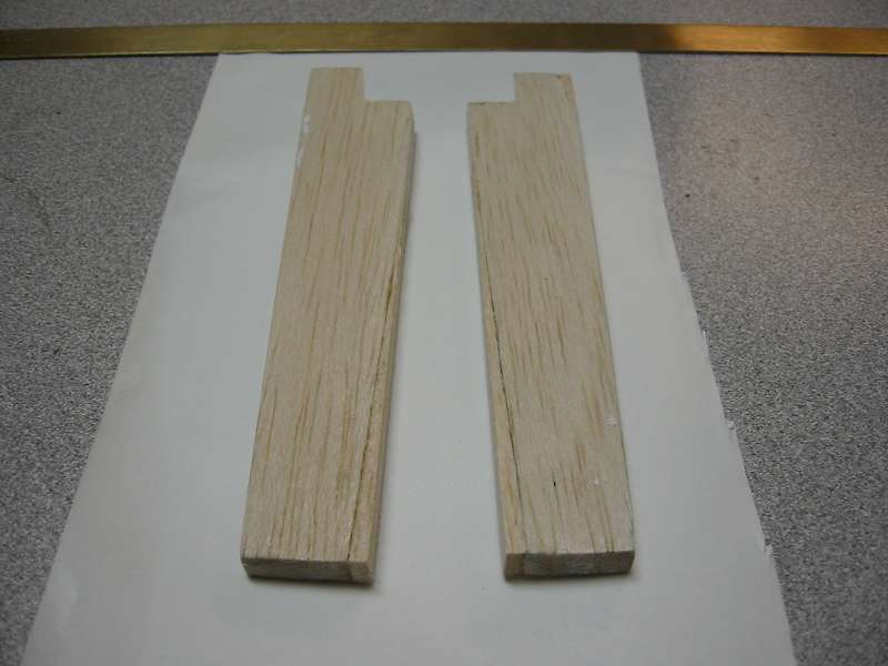

a. We added 1/8 x 1/4 balsa strips to the elevator fillers and trimmed/sanded to make the gap with the elevator even and parallel. Then re-cover with white Ultracote.

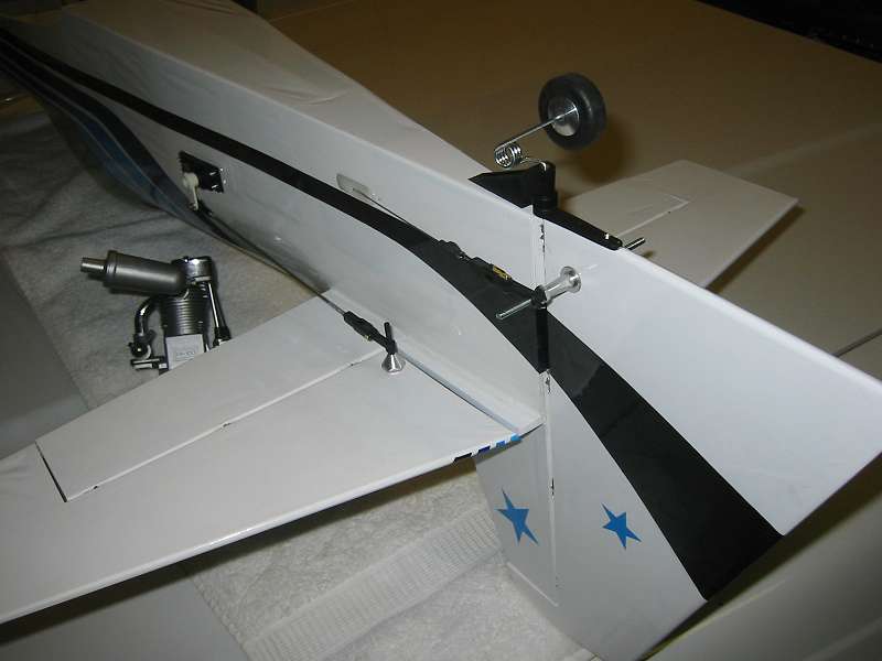

b. Before installing, we test fit the vertical stab. It required a bit of trimming and sanding to get the back edge flush and inline with the end of the fuse.
c. Then, put it all together and mark all around with a water-based ink pen.
d. Cut just inside all the lines about 1/16" and remove the coating for the glue joints on the veritcal stab, fuse, fillers and horizontal stab.
c. Install the vertical stab, and straight-edge the rear to the fuse again. Check square to the horizontal stab (lucky this time, it was right).
d. Wick in liberal amounts of thin CA while pinching the tail slot together against the v-stab.
e. Install the fillers and wick in thin CA all around.
f. We used the white RTV silicone to finish all the joints. This provides fuel sealing and improved appearance.
Now we're making some progress.

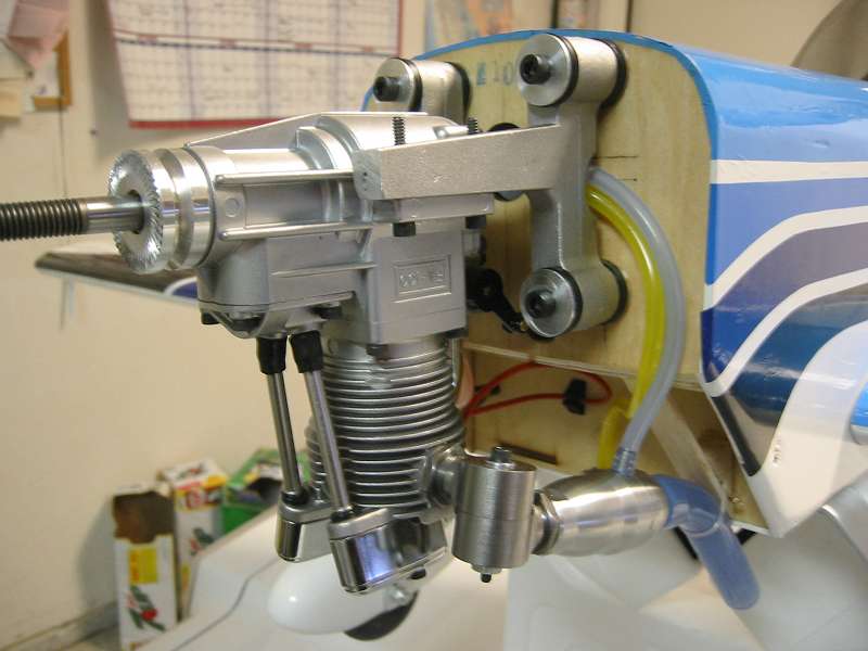

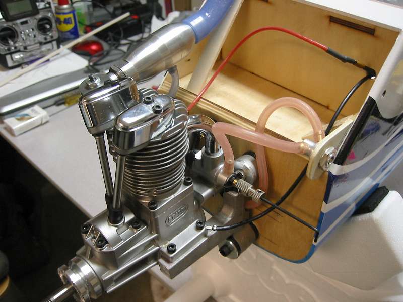

We are also warming up a new Saito 100. Have 7-8 tanks thru it so far on the test stand. Looks like a APC 14x6 should be about right for the prop selection.
BTW:We rigged the Rudder last night. Photos later. Word of warning... more badness in the design was discovered[&o]. The cables on the pull-pull go thru slots hidden under the covering. When you try to pull the cables thru to the servo, they will be forced to route inward thru the center of the rear bulkhead. Without correction, they will drag and saw on the bulkhead. There is not a straight-line shot to the control horns from the servo. We were lucky to have a 12" long 1/8" drill bit handy (got it at Lowes), and managed to drill thru the cable slits into the bulkhead to make it a straight shot. It's still not perfect, but to do it right would require removing the covering on the fuse. This is our first pull-pull rigging, but that sure seems bogus to me!
#65
Joined: Oct 2004
Posts: 1,492
From: Temecula,
CA

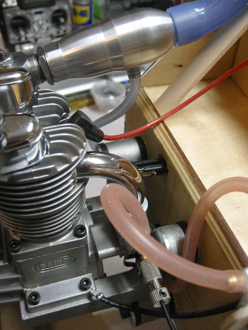

We're not far enough along for balancing yet... still have engine, aileron, fuel tank and radio/battery to install.
Every step of this build is presenting new challenges [sm=drowning.gif]. There was absolutlely nothing in the manual about the pull-pull rudder install, not even a picture showing it finished. Somewhere in the middle, the elevators and rudder magically appear installed. Now we see the rudder will need to be trimmed for the tail-wheel hardware to mount up. The rudder hangs down more than 1/8" below the fuse bottom when you have a reasonable gap in the rudder clearance at the top. This kit was not ready for shipping when they finally decided to let it out
We are debating engine mounting. Should we mount head-down or head-right on this thing. Seems we may avoid cutouts if it's head down, but I see from other postings that we might need an on-board glow starter if we do that, to provide a reliable idle. Anybody have input on this?
Also, we bought a 16 oz tank for this plane[>:]. Is that too big?

Here is the tail feathers all done. We put in Dubro cable guides and upgrade all control horns and links. We also installed Dubro pin-hinges. Rudder and Elevators are really smooth and loose.
The tail wheel is not very high quality. We'll probably change it out later. It's kinda loosy goosy and doesn't seem to be held well with the little screw on the shaft. We put a flat-spot to secure it better.

And now the engine install...
We decided to mount inverted. There would be too much cowl cutting to mount righthand with this big Saito 100. Test fitting showed almost the whole head would stick out of the fairly narrow side-bulge in the cowl, really breaking the nice lines and making it weak. We upgraded to a Dubro 686 vibration reducing mount ($37). I'm sure the plastic one supplied would work fine, but we have become obsessed with making this thing sweet
[:@] CAUTION: There is another serious error in the instructions. We carefully test-fit the engine and cowl, and discovered that if you use the 5-1/2" offset for the prop hub to the firewall, the cowl will not reach the fuse at the bottom. It must be no more than 5-1/8", and at that it just barely covers at the bottom edge. I would recommend shooting for 5", but the carb is right over the bottom-left mount screw.
You must reverse the carb to get the throttle in the middle. Even if you use the stock mounts, you will have to shave a much thinner face where that mount screw is located. It's really tight. You can see we had to cut half of the mount thickness off, remove one vibration pad and still had to countersink the bushing and machine the 10-32 socket head screw to get it in this location. Lots of work here.
The thrust-line center location (in the manual) turned out to be pretty close, but with our experience thus far with this kit, we took a lot of extra time test-fitting to check it.
We put in a Performance Specialties Twister muffler ($70) and a AeroTrend Blueline #1024 pipe extension. We discovered that the stock muffler is nearly completely out of the cowl with the engine inverted. The 90 degree exit and close profile allows this muffler to stay inside the cowl and exit underneath neetly with a 4" extension pipe. We will finish that install with an angled ply spanner (shown not yet installed) from the Firewall to the lower bulkhead so we can wire-tie the pipe extension securely and have just a little notch in the bottom edge of the cowl. The pipe sticks out about 2" below the fuse.

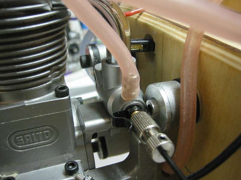

We installed a remote-glow tap (Hanger 9 HAN3025). This thing is real nice... much better than the Dubro I put in my Funtana. We also put in a Dubro Kwik-Fill Fuel Valve (Dubro #334) and mounted like they showed in the manual with a flange.
The Throttle Linkage was a challenge too. It ends up right against the short floor step, and requires some handy dremmel sanding with a 1/4" diamerter wheel to trim the floor wall inside, back about 1" to make it a clean shot. The control rod was upgraded to a #2-56 Dubro #102 Kwik-Rod and Dubro #815 Safety Lock Kwik-Link. The little thin wire supplied was sloppy in the Saito Carb horn holes, and I don't like the bent-wire approach because it makes assembly & service difficult.
.[:@] CAUTION: There is another serious error in the instructions. We carefully test-fit the engine and cowl, and discovered that if you use the 5-1/2" offset for the prop hub to the firewall, the cowl will not reach the fuse at the bottom. It must be no more than 5-1/8", and at that it just barely covers at the bottom edge. I would recommend shooting for 5", but the carb is right over the bottom-left mount screw.

You are right about that Quik-fill. We just ran the engine to see how it does, and when we were done fueling, it would not close. I took it apart, the plunger was stuck. I got it out, streatched the spring real good and reassembled. Blew into the ports with hose, nice and tight now.
Here is the finished engine install. The yellow line is the crank vent line. Used a cable television cable clamp, shaved on the underside so it pinches the hose nicely.
The second shot is the finished wing all set up. Used Dubro Pinned Hinges, upgrades on links and horns, all #4-40 hardware. Already thinking those servos need upgrading. Landing Gear installed too, with the new wheels.
Installed a Sullivan Vee Style 16 ounce fuel tank (BT-16 No. 390) which has a very low profile. It sits right against the front fuse roof with 1/2" Dubro Foam Rubber pad (#514). Leaves just enough room for the throttle line under it. I don't think you will get the throttle rod past the stock tank, too tall... but I could be wrong. We wanted more fuel. so we never tried the stock round tank. (photo later)

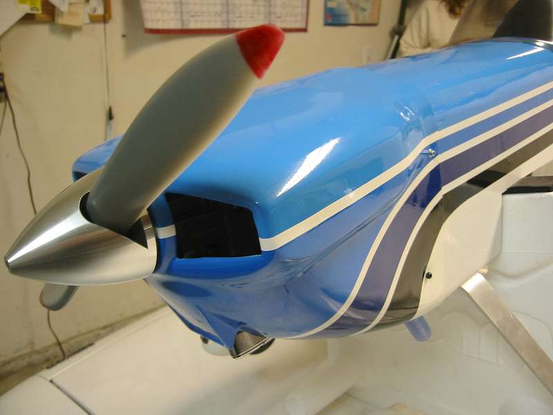

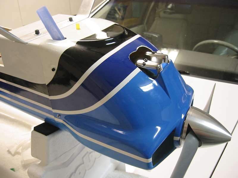

Got the cowl all cut out and mounted [sm=lol.gif]. Right side has fuel tap and needle valve extension, left side is clean. Bottom has head cutout, exhaust pipe and crank drain. The paint on the cowl is very brittle and peels easy. See all the chipping around the head cutout. BTW: Previous photos show the exhaust pipe with the elbow on top. Had to reverse it to get in on the bottom so it missed the cowl.
Question for you pros... Do we need to put any additonal vents for better airflow in the bottom?

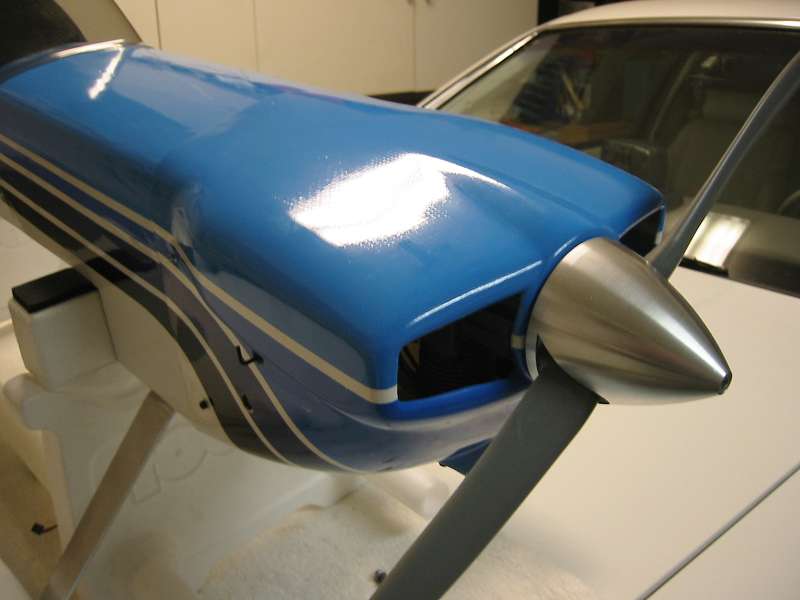

New problem [&o] : We know the motor is mounted dead right... but to get the cowl to center about the prop hub, it had to be pulled down such that the top cowl has a big bulge and gap over the top of the fuse at the rear. You can see the bulge in the two upright shots. I had this problem with my first Funtana, and the only way to fix it was to take off the skin and sand the top front fuse profile so the cowl is relaxed and not strained, then recover the fuse. Does anyone have a better idea how to fix this?
We have looked far and wide. We can't match the color of this top vane of blue. Ultracote, Monocote & others don't match. We found some Monocote decal sheets that do match, but that won't work for this. We need to find out what this stuff is, and get some to fix this. It will fly like this, but it looks bad.
