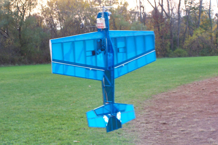

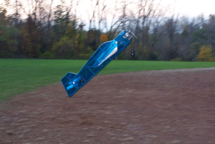

SPink, that is a thing I overlooked, I will never maiden on my own, too much risk with the stress that I'm under
Second flight was by myself, short underarm push, straight into a hover

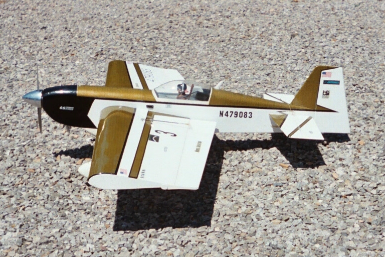

Sometimes I don't follow my own advice and will takeoff after 2 or 3 quick taxi runs.
Thats how I flew this plane.
I am on a limited budget so with expensive plane (500$+) I literally can't afford to lose the plane.
Matt
