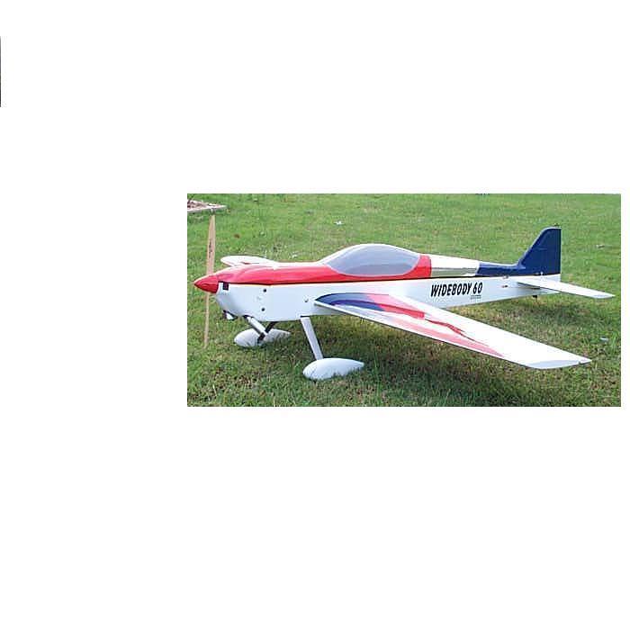

Never heard of a wide body 60. Can someone post a pic or a website, so I could see one?
Thanks, TME
Old 08-24-2002 | 10:00 AM
Dansy's Avatar
My Feedback: (53)
Posts: 3,001
Received 165 Likes on 147 Posts
From: Prescott, Ont.
Default wide body 60
Looks like a nice plane.....the link is;
http://www.marcelocolombo.com.ar/
Daniel D.

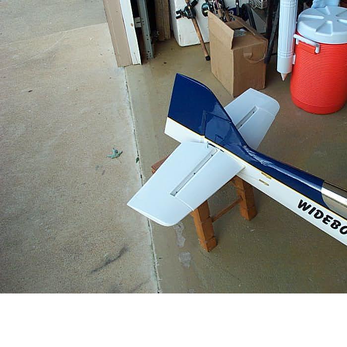

Old 10-04-2002 | 09:58 PM
Posts: 48
From: Paris, TN
Default widebody
Here is the tail mods I made. Who knows what it will do, I am just a back yard engineer!
Old 10-04-2002 | 10:34 PM
My Feedback: (15)
Posts: 1,087
From: Kennesaw, GA
Default ifly2low.....
Looks killer! I plan on using the same motor on mine.....
Looks great....
What size did you make the control surfaces?
Pug
