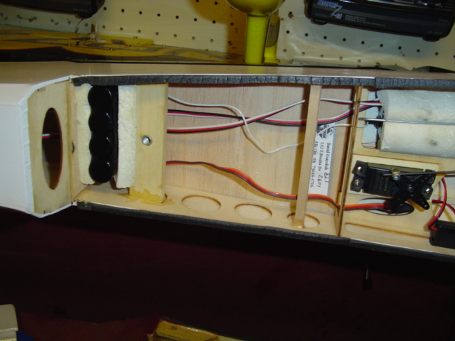

Default RE: Funtana 40 CG
With a Saito .82 and stock spinner. This set up will get mine at 6-3/8". I am also running the cowl and pants.
I have the engine slide back as far as possible with out moving the top left motor mount bolt.
david
