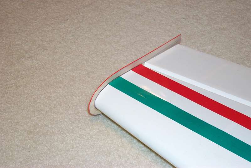

#33
Posts: 2,914
From: Canton,
MI
The wing tips work!!!
They really helped the high alpha wing rock. The wing still will rock, but the rocking motion is much slower. Therefore, I can counter the wing rock using aileron, and it is very manageable.
Also, I do not recall experiencing any tip stall during the 2 flights I took.
It does slow down the low rate's aileron effect. Aileron now is less touchy on the low rate. High rate is still blinding fast.
Furthermore, it lands really slow now. Don't get me wrong: it landed slow before the tip plates, but it is like walking speed now. Must be the extra lift near the tips that didn't get lost that's retained by the tip plates.
I have not tried inverted harrier. It did not rock during inverted harrier before the tip plates, so I don't expect it to be much different now.

Word of caution on that one. I would strongly recommend you don't add any material to the ailerons themselves, but just let them sweep against the plates that attach to the wing tip. The reason? FLUTTER! Control surfaces as large as those are already prone to flutter, and adding weight and mass to them aft of their local cg will exaserbate the condition, probably with catastrophic results. Just make the tips wider to accomodate the aileron travel, even if they are a funny shape. I feel you will be much better off.
As for the wing rock upright and not inverted. That condition supports what I believe to be the real culprit with this airplane. It's not a function of the wing or wing tips, but rather a function of YAW stability, that is substantially reduced when the vertical tail is blocked by the fuselage and horizontal tail. I have already added a dorsal fin to my Funtana 90 to improve the knife edge flight, but now I think a VENTRAL fin may be the fix for the wing rock. The reason the tip plates helped, in my opinion, is because they added side area and perhaps increased yaw stability. Just a thought

Not24 and all,
What you are saying about the tail surface being blocked does make sense. At first I was thinking that wing rock was a function of the thick airfoil that 3D planes have in conjunction with the vorticies being generated off the wing tip shape. But I don't think that wing tip stall is the issue here because both tips stall at the same point. A rock assumes that the tip stall would alternate causing the rock. I have never seen a plane tip stall to one side and then recover. I have seen planes stall straight ahead and then pick up speed and then recover causing porpoise action. This I have seen with many different wing tip shapes.
I have noticed that profile planes usually harrier very well. My profile foamies are solid as well as the OMP profile planes that I see fly. These both have drastically different airfoil shapes.
But a profile will have great YAW stability. Its fuselage works like a "huge rudder" and is stable right side up or inverted.
The wing plates probably did add to the YAW stability as well as give wing tips more effectiveness at stall speeds. Sorta win/win. But keep in mind that they will still stall.

I would like to bring forth my skepticism of yaw instability being linked to high-alpha wing rock. Take UCD for example. It has excellent yaw stability, but will start rolling back and forth while attempting high alpha vectored flight.
Another example, Goldberg Extreme 330 profile has also great yaw stability, but has considerable wing rock during harrier. But its brother Extreme 540, with a different wing, is much more stable during harrier. I'd say these 2 planes have similar yaw stability. I owned both.

Certainly there are many factors that contribute to aerodynamic stability but ...
The idea is, that at high alpha, the air flow is blocked by the elevator reducing the effectiveness of the rudder. That is why inverted harriers are more solid. The rudder is not blocked and gets direct airflow. The UCD has a flat bottom, so when at high alpha the rudder is blocked and the fuselage acts like a wing not a rudder making the high alpha unstable. Kinda like droping a piece of paper. The UCD is much more stable in inverted high alpha manuvers (I have one). The top of it is round and skinny, not flat, and the huge rudder is in the main air flow. Check out the Harrier 90. They made the back of the fuselage tall and skinny. No doubt for high alpha stability. The whole back half of the fuselage is like a vertical stabilizer.
As for the Goldberg Extreme 330 profile, my understanding is that is has a lot of bad tendencies and there are always exceptions to the rule. A forward CG or warped fuselage could also be hurting you there. But in general, the profiles are fantastic at high alpha.
At the same time, I am not completely ruling out wing design. I just don't think it is the main culprit for wing rock.
