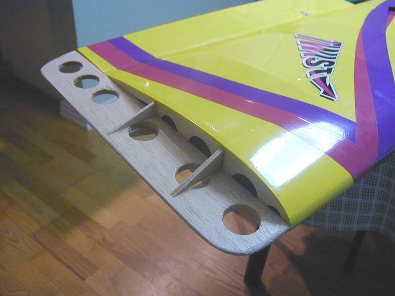

I recently converted the wing of my TWIST to tapered wing tips, similar to the UCD. I also fly a Seagull Razzle and she does Harriers much better than the TWIST. Also the TWIST won't do KE at all. I am hoping
that this will cure some of its shortcomings[img][/img]
