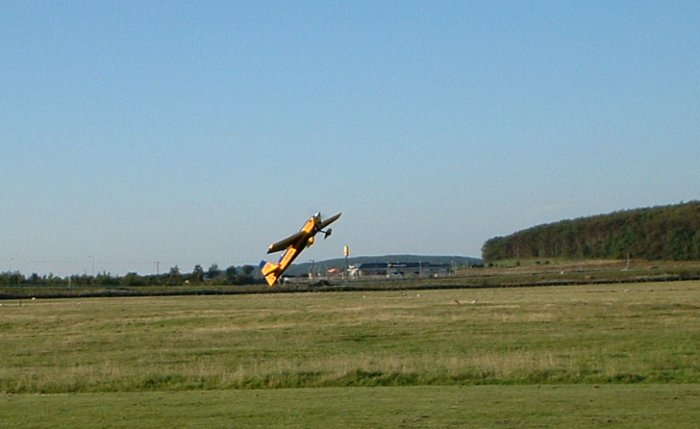

MY Edge is 12lbs. Attached is a pic of it in the harrier...... this takes about 1-2/3 throttle, fully vertical takes full throttle, so not really the right engine for the model, but not too bad. The glow version would be perfect.

Nice looking harrier! What prop are you using with this combo? I am putting one of these motors in a Creek Hobbies Extra 330. I don't know which prop to use so any help you can give will be a help. Thanks, I am hoping for 11.5 lbs on my Extra. Hope it is not too much of a dog... OH well

prop is an APC 16x8..... I preferred Mejzlik but damaged an end of that prop following a wheel locking up taxying- bit of a shame really as the damage was incredibly small, but i think too much to make it usable.
Should be fine...... i'm using the spoileron mix..... hopefulyl with hat on permanently during the harrier it will be even more steady.
