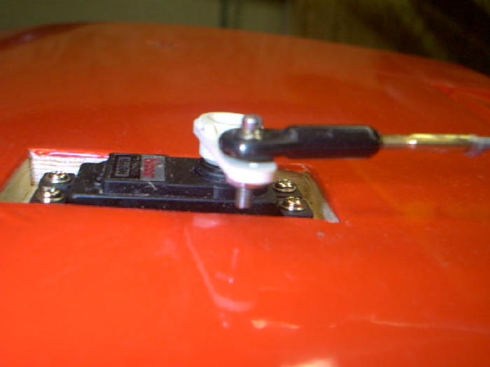

sounds awsome, like you really did your research and figured it all out. I plan for my next plane (next summer) to be a Creek Katana. You have researched well and built the plane very similiar to how I was planning to build mine. I have a couple of questions?
1. did your cowell match the covering, if not how did you make it match?
2. Could you tell me more or send pictures of your rudder setup, Why did you use CF rods and bellcrank, why not just standard pull-pull cables?
3. Rocket city horns with swivel ends? Dumb question, but could you tell me more about swivel ends?
4. I am currently saving for the Katana, I will not purchase anything untill I have enough funds to get it all and do it all right. If you don't mind me asking what was your total investment? ( e-mail [email protected] if you don't want the answer public)
5. Does the turbo jett give you a significant power boost?
6. how far back is your 20 OZ tank? Could you locate it under the CG with a pump?
Thanks in advance.

Dntmn,I used the bellcrank system for two reasons,one,is that by using the bellcrank I am able to tighten the cables without pulling on the servo output shaft,wich loads the servo causing battery consumption and premature wear of the servo,and two it allows the cables to be centered without having the servo dead center and both cables are equal length.The cowl color does not match,and I left it like that,chances you will make it worse trying to correct it.I used the Turo Jett Muffler because My experience with the Bisson is that it does not provide enoughback pressure for consistent performance,please no one dog me on that statement,it is only my experience,I am not saying they are all bad.I also read here on RCU that it provides a significant increase from several people,also from Dubb Jett.My tank is in the stock location,I Don't think it will go any further back with the servos up front.I used the carbon fiber and Titanium rods because they were supposed to be half the weight of standard rods,that was not ture,but they were lighter,and I had them,so I used them.I kept the weight down by researching exactly what I wanted to use and weighing everything on a digital Postal scale before I used it.This may sound extreme,but I have built several 3D type 1/4 scale planes without much concern to weight,even using 2.4 gassers.After arguing on RCU,that the weight of the gassers was worth it and not a big deal,I finally found out that my 3D ability sucked because the planes were just to heavy.I swithched from a 2.4 to a 1.60 on a H-9 Edge,and found out I really could fly 3D,so now I go to the other extreme and build as light as possible,without drilling all kinds of holes etc.I will post some pics as soon as I get my printer working again,I don't know exactly what I spent,But will try and guesstimate and let you know.As far as the R/C swivel links,they are ball links on the servo end and swivel links on the control horn end,here are some pics from my Lanier Edge,it does not hve the CF rods,but the hardware is the same.Sorry to be so wordy tonite,but I hope the info helps.

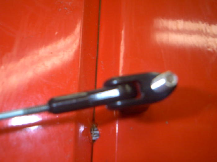

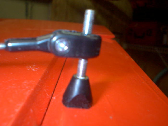

I sent the pics E-Mail,my photo program is in working and I can't resize them.
Mike.
Old 09-28-2002 | 03:49 PM
Mike Rojas's Avatar
Posts: 845
From: Covington, LA
Default Katana First Flight
pic
Old 09-28-2002 | 04:30 PM
Mike Rojas's Avatar
Posts: 845
From: Covington, LA
pic3
Mike Rojas's Avatar
Posts: 845
From: Covington, LA
pic2

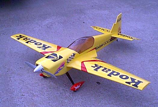

Default cowl match
I used Rustoleum Sun Yellow out of a rattle can to come real close to the covering on the Katana. I used Rustoleum primer, then the yellow, and then Rustoluem glossy clear. While the match isn't perfect, it is much closer than stock. I have used Rustoleum in other glow models and it has stood up well to 15% nitro. I am waiting on digital servos for my Katana and hope to have it in the air in a week or two.
Jpflyer

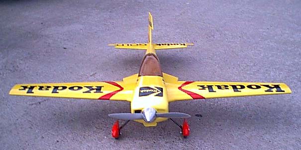

Default more pics
another pic of the Katana cowl.
Old 09-29-2002 | 05:58 PM
My Feedback: (13)
Posts: 254
From: Corpus Christi, TX
Default one more
and another
