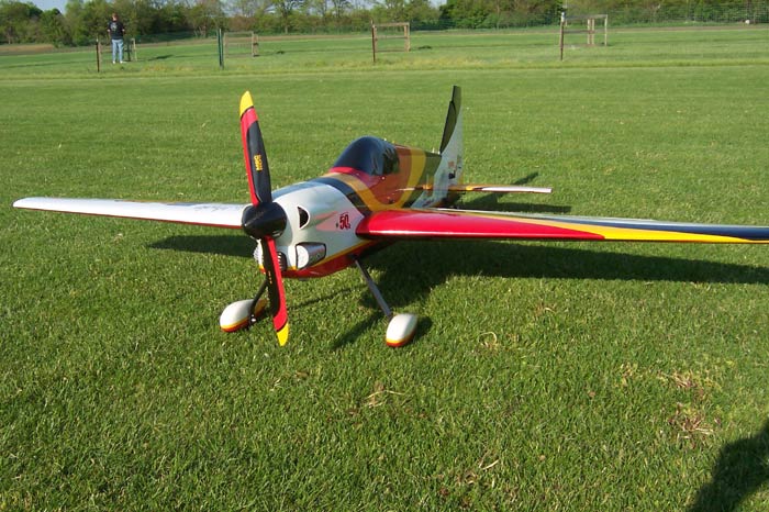

Well, I thought it was time to follow up on this thread and post a more comprehensive evaluation. After about 10 flights, I have some news that is a bit different than what I originally experienced on this plane...
As I mentioned earlier, I did a number of mods to my Vision that contributed to a somewhat tailheavy balance situation. Most of which I think could have been avoided had I used 2-1/2" standoffs instead of the stock 1-1/4" DA standoffs. At any rate, I needed 13 ounces to balance at the recommended CG of 3-1/2" back from LE at wingtip.
After quite of bit of testing, I found that I was able to move my CG back about an inch to 4-1/4" which is just at my limit for my skills. Anything further forward and I found that hovering was impossible and walls were not very good (some snapping). Anything further back from 4-1/4" and it got a little too pitch-sensitive and came in a little too "nose-high" on landings for my taste.
Moving the CG back to 4-1/4" allowed me to remove 7 ounces of lead from the nose
bringing my AUW down to 16.3 pounds. [sm=thumbup.gif] That's still a little heavier than a stock Vision, but much lighter than 80% of the planes out there this size. It has unbelievable vertical power at this weight and has great slow-flying characteristics, so weight and/or wing-loading is not a problem.
With this rearward CG, I found that my walls are very clean now, no snapping at all. I can hammer full down-elevator tumbles all day and not even lose any altitude. Harriers are great, axial rolls are very precise and extremely fast. Knife edge is average at higher speeds, but messy at low speeds. I still cannot get it to flat spin upright or inverted, but it does an awesome wingtip/knife-edge spin. I'm still finding it's snap rolls to be the prettiest I've seen and you crank out tons of them subsequently without loss of altitude.
Hovering is easier now than with the forward CG, but still quite difficult. The plane just keeps wanting to fall off to the left side even with full high rate right rudder. I thought that this was due to needing more right thrust, but I've heard of others that are still having this problem even after adding right thrust.
As far as durabilty goes, after 10 flights, all bolts are holding tight, airframe is sound and nothing is rattling loose yet. My Hobby Lobby hatch latch is working perfect, and I've had no problems with the HS5995TG robot servo on the rudder.
Overall, I would rate this plane an 8 out of 10. A score of 10 would only go to the Extreme Flight 87" Yak 54, and my previous Wild Hare Edge 540 would be something like a 6. So, all in all, it's still one of the best planes I've ever had. I don't know of anything else I've flown that I wold give an 8 or higher too (except the Yak). I need to spend more time with this plane figuring out the rates, mixes, and exactly what it wants me to do to persuade it into some of the elusive manuevers, so I'm not really 100% sure that the score of 8 won't go up or down 1 point by end of summer.
If it would only hover and flat spin like a Yak, it would be a 10 in my book. Those two things are why it's missing those last two points IMHO.
I still would reccomend this plane to those that can't get their hands on some of the new Yak models that are virtually impossible to find, or would prefer not to hassle with the setup of a biplane like the Double Vision. This plane is certainly no DV, but deserves to remain in the family. Sometimes you just want to slap the wings on and go, and not have to hassle with setting up a biplane at the field.
Of course, I've got a DV in the box, so I hope to have one of those ready to go later this year to.
Tom
