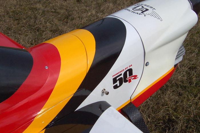

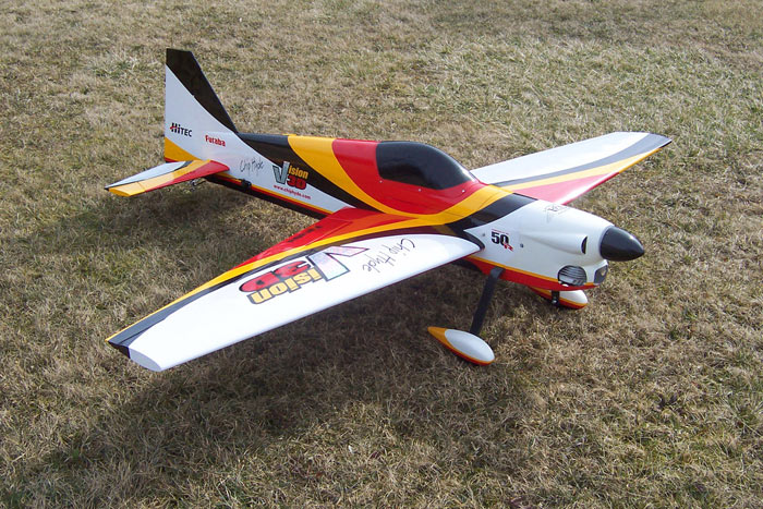

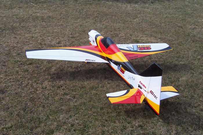

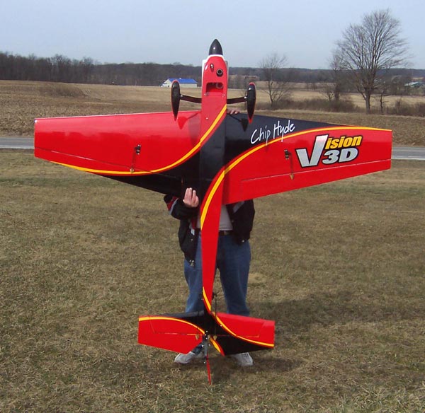

Hiya guys, just finishing up my Chip Hyde V3D and thought I'd share some of my "custom" mods. Still waiting on my prop, but here's some pics of my covering scheme. I stripped the stock covering off completely, made a few internal mods, and recovered with a scheme of my own design. First I'll show some pics of the finished covering scheme, then I'll discuss the other mods I did.
Tom
Here's my ugly mug with my V3D. As you can tell by the grass, it's not quite flying weather yet... 20-30 degrees and snow is coming tonight... again!
Tom

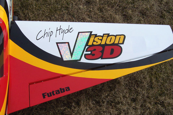

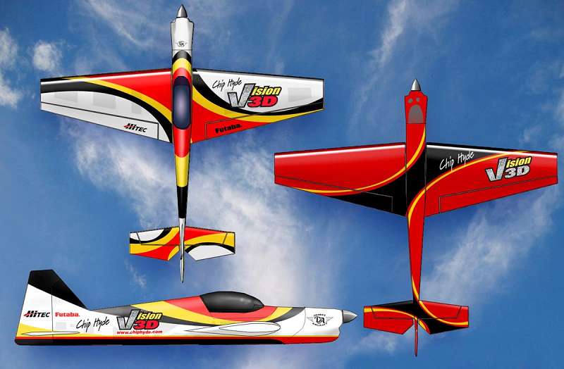

I designed all graphics in Adobe Illustrator and Photoshop first. All covering was cut by hand in Ultrakote. Logo graphics were cut by my buddy Dave "Maudib" Johnson on a vinyl cutter (Thanks Dave!).
Tom
Tom

Here is some more info on my build...
I used a DA50 for power with a stock DA muffler. Had to cut the crap out of the cowl, but it doesn't look too bad. Servos are Hitech 5945 all the way around, except for a 475HB on the throttle and a 5995TG on the rudder.
I used carbon fiber landing gear, spinner and tailwheel, a 1400mah Nicad on the ignition and will use a Lithium pack for the Futaba PCM receiver.
I've got a SmartFly regulator/Miracle switch with a pushrod adapter on the switch, mounted just over the wing.
Lightweight tires came from BME Aircraft, and are extremely light at 2.45 oz for both wheels!
I used a Hobby Lobby hatch latch that was epoxied into a recess in the styrofoam turtle deck. The release pin was removed and Loc-Tited back in with an aluminum sleeve extension added.
Tom
Tom

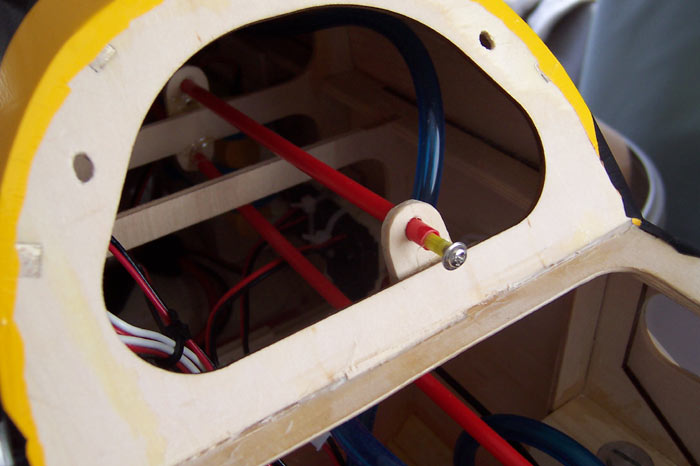

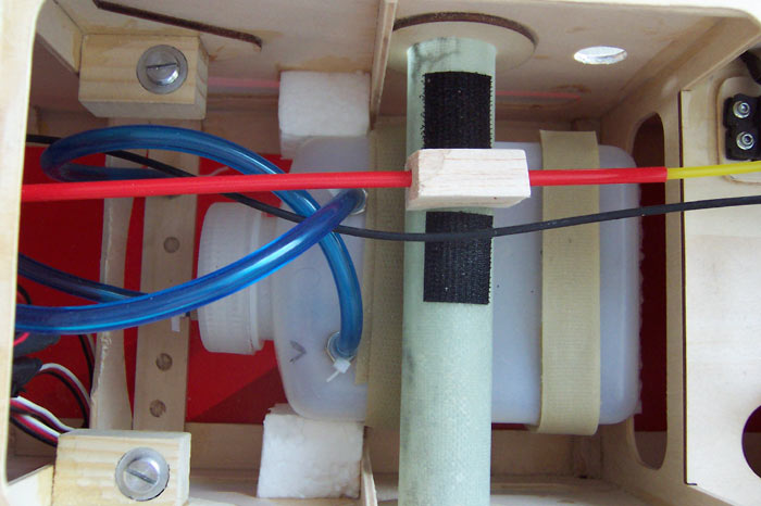

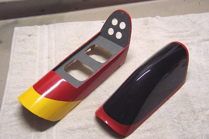

Here's the canopy mod. I also blacked it out from the inside with Krylon Fusion black spray paint. The outside of the canopy was trimmed with Ultracote red paint and clear coated.
Since the canopy was blacked out, I decided to cut out lightening holes int the canopy hatch framework.
The tank was moved to CG, mounted under the wing tube and can be removed through the hatch if needed.
The choke was finished by adding an aluminum servo arm on the choke armature, then a pushrod was extended back into the canopy hatch area.

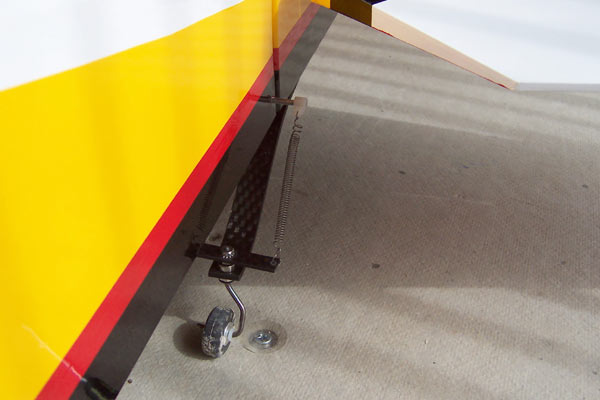

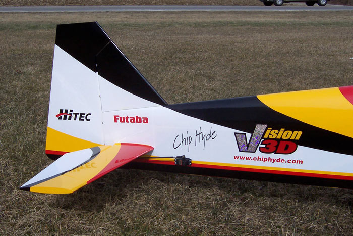

Here is a shot also of the carbon tailwheel, with the tailwheel/rudder linkage. I added a wood block inside the rudder at the bottom to run the bolt through the rudder for the tailwheel springs.
Tom

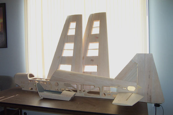

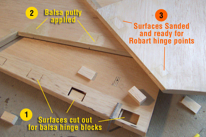

OK, back to the beginning. After stripping all the original covering off, I found a few issues that I decided to modify...
1) The hinging. I didn't get a "warm and fuzzy" feeling about using the supplied CA hinges on a bird this size, and the stock hinge slots were double-cut, crooked and just didn't look sound to me... so I opted to go with Robart Hinge Points.
Unfortunately, there didn't appear to be enough balsa in the LE and TE of the surfaces, so I had to add some. I cut out areas in the sheeting and installed some balsa hinge blocks at all hinge points of all flying surfaces, drilled them out and installed the hinge points.
2) Next, I found over half of the ribs in the both wings to be broken. However, they had obviously been broken during construction and glue applied to strengthen them back up. They seemed solid, but reminded me of a broken bone that had healed without ever "setting the bone" before healing. Healed in a crooked/disjointed position. So, I didn some rib scabbing to fix this issue before covering the wings.
3) Lastly, I decided to add some balsa tri-stock in critical areas around the formers from the canopy back to the tail. Not much, just a litle added support for such a light-weight build.
Tom
Tom

Hey Neo great looking plane, I've drawn a design of my own on paper and trying figure out how to transfer it to the plane. but was wondering how you set up your Illustrater to match the plane
Posts: 1,194
From: Newark, OH
I took 3 photos of the stock V3D into Photoshop first... Top, bottom and right side views. I cut them out of the backgrounds and paint the planes white... this is your base. Now, using layers in Photoshop, I design the overall color/graphic scheme, right in Photoshop, not Illustrator. Once I'm happy with the overall scheme, I then go to Illustrator.
In Illustrator, I design all the logos, text, etc. and save them as EPS files. Now I go back to Photoshop and load the EPS logos in (rasterizing them) in PS. Now you bring those rasterized logos into your main Photoshop file as layers. You can scale, duplicate, reposition, etc. in Photoshop to position them on the different views of the plane. Before you know it, you've got your final, completed design.
Next, I print out a copy of my 3 Photoshop views and use it as a guide to hand-cut the Ultracote when covering the scheme. For the logos and text, I send the original Illustrator EPS files (vectored art) to the vinyl cutter, and tell him what size to cut them at, what colors, etc.
To figure the size of the vinyl graphics, you refer back to your Photoshop printout, measure and scale accordingly. For example, if the Vision wing is 40" long, and the same wing is 4" long on your print, you know your scale factor is 10%. So if the wing logo on the print is 1/5" long, you take that times 10 (15" inches) and tell the vinyl cutter that the logo should be cut at 15".
You only need to give him one size of the logo, then tell him what different sizes you need it cut at.
Here's a copy of my original V3D scheme done in Photoshop, with the Illustrator logos added into it. I modified it a little when I actually put it all on my plane, but overall it's pretty much the same design.
Hope this helps,
Tom
Hope this helps,
Tom

One other thing regarding my "mods"...
I just used a borrowed prop and battery to check my CG [:'(]
I'm coming up extremely tailheavy and may need to add as much as 3/4 pound to the nose to balance! [:@]
How and why? Not "entirely" sure but here are my thoughts...
1) I used the 1-1/4" standoffs, some are using longer standoffs, pushing the engine weight further forward. But some are using the same standoffs I did....????
2) By replacing the stock CA Hinges with Robarts, I added the weight of the Robart Hinge points, AND the weight of the balsa hinge blocks and glue... waaaaay back there in the tail (as well as wing TE). I may have added as much as 1-2 ounces to the tail doing this now that I think about it. That's a 4:1 ratio from tail to nose for balancing, so 2 ounces in the tail means 8 in the nose to balance.
3) I used Carbon Fiber landing gear and spinner, so I lost about 4 ounces in the front end that I'm going to have to add back in now.
4) Maybe an extra ounce or two of covering and viny graphics from the CG back that aren't on a stock plane... that means another 2-4 ounces needed up front to balance.
CRAAAAAPPPPPP!![:'(]
BUT, this is all based on the "suggested" CG point. From what I hear, some guys say their V3D's are nose heavy (which is why I wasn't originally worried about tailweight). If in fact I can move my CG back some from "suggested" point... maybe I can get away with about 1/2 as much ballast in the nose.
Without ballast, I'm at 16 pounds even. So it looks like I'll be at 16-3/4 pounds on the maiden. If she doesn't feel tailheavy, I can slowly remove ballast until I reach the "danger zone"
Oh well, even at 16-3/4 pounds, that's a lot lighter than my last plane (WH Edge with a BME 50) and this plane has more wing area. My Edge was 18-1/4 with Smoke and about 17-1/2 without smoke... still flew great. Also, the Double Vision is around 17-1/4 pounds and is a rocket on a DA50, so I'm at least a half a pound lighter "with" ballast. Should be fine.... we'll see.
Tom
Tom
