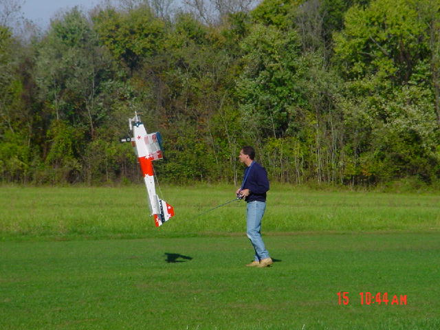

Sherlock, you asked for opinions. I did give mine in saying I liked the pro as well as the mejzlik. It is just an opinion, and I have lots of empty fuel jugs to back me up. You like the mejzlik and that is fine, but I did not come up with some comparison to invalidate my findings. I have found that the pro accelerates as well, just my findings. Obviously you felt different and that is fine. But you have to agree that any 20" prop is too much. We tried those too, and found the same. The pro is a "low quality prop" is your opinion. The attached picture shows the pro does the job.
Best of luck, Jeff Williams

Zinger IS known for being an inexpensive prop..not only because it dosent cost much but they are not as good of a design (air foils)as others...That statement is True...Why does everything have to be an opinion????I did try the zinger side by side of the mejzlik...sorry They are two different animals in all aspects..Including Performance...I have no problem of the zinger being used...Just held in the same catagory as the Better Higher end props..
By the way I saw Jason Shuman take a magic that was fitted w/ an all electric setup..He flew it amazingly..but when he was done he said he didnt like the plane or the way it handled..so my point is just because a plane can...lets see...Hover for a picture, dosent mean that the prop on it is a better performer then others...or the plane is flying at its full potential.
So I guess In your point of view Its just an opinion....Or is it...You know I have stated in days past that the sky is blue is that only my opinion??? or, could that be a fact????

Scott, opinion or fact I will let you decide. I too ran the mejzlik side by side my pro and I really saw minimal difference, if any difference so I spend $40 for a mejzlik or $18 for the pro. I go with the pro for the price and to me, no performance loss. I will fly the zinger and you fly the mejzlik and we will both be happy. The picture was just to say I like the prop and what it does for me. I agree with Jason Shulman, the magic is not very good and way overrated. After flying that plane I would not purchase one, just an opinion because they are selling the heck out of them and plenty of modelers like them. I have no hard feelings but it is always fun to discuss the hardware for these planes we love.
Happy contrails, Jeff Williams
