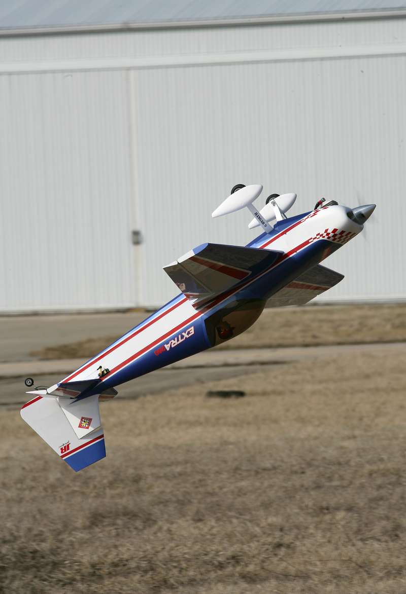

Here are some pics of the bird. It seems heavy to me at 15lbs with a DA 50? and only like 12000 square inches of wing area. I want to get in to the 50 cc'ers but is this bird a mistake?

15 seems light for a DA 50.. it will 3D a 18 lb plane no problem. Im sure it will fly great Mike designs some nice flying planes. the 33% extra flies like its on rails.

15 lbs is not heavy for the DA, but yes it is heavy for this plane. This plane only has 1134 squares which amounts to a 31 ounce wing loading. Compare that to the larger size of the EF Yak, for example (which brings up the reynolds numbers) and its 23-24 ounce wingloading. If you have ever seen a Great Planes Patty Crapstaff fly with a gasser, that's about what you can expect. If you like that, you'll like this, If you have ever seen or flown an EF 50cc Yak, I don't know why you would consider one, IMO. I have been doing some figuring and I don't even see how one could get this thing down to their advertised low of 11.5 pounds, even with a Saito 180 or YS 160...maybe 12.5.
I was excited about this plane for a lighter engine, but I just don't know now. I have My Yak and I don't see the need to downgrade...
