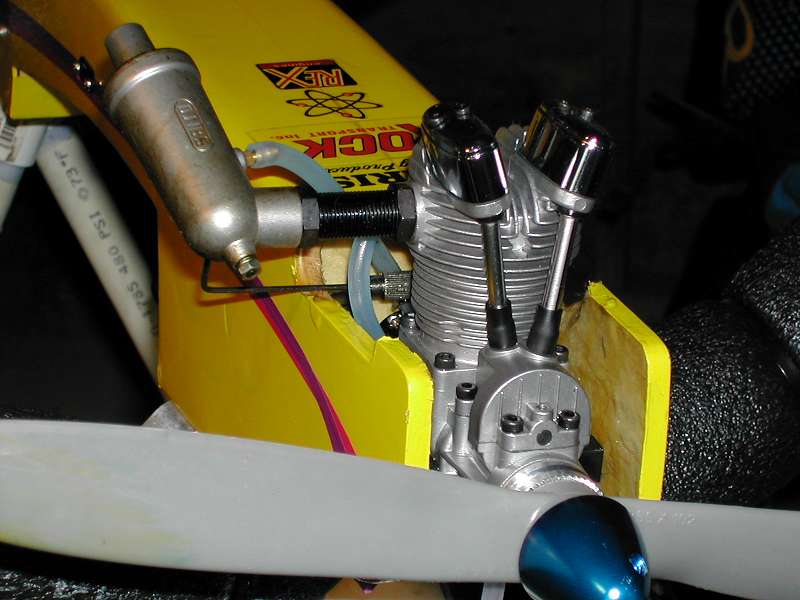

Since you have the choice, I'd absolutely agree with the last two posts... go with a 4 stroke for this plane. I'm running a Magnum 91 RFS in my Twist, swinging a 15x4W prop, and it is a fantastic combination.
For learning 3D, you just can't beat a 4 strokes ability to provide quick throttle response, swing nice big props, and make the maximum use of that little tank you get with the Twist. Plus, they just sound so cool!
If cost is an issue, you can sometimes pick up a Magnum 4 stroke for not much more than a comparable 2 stroke if you keep an eye peeled for sales and specials at Hobby People (I picked my 91 for just $139). Regardless of what you may read, the Magnum RFS 4-strokes are great engines and a real bargain.

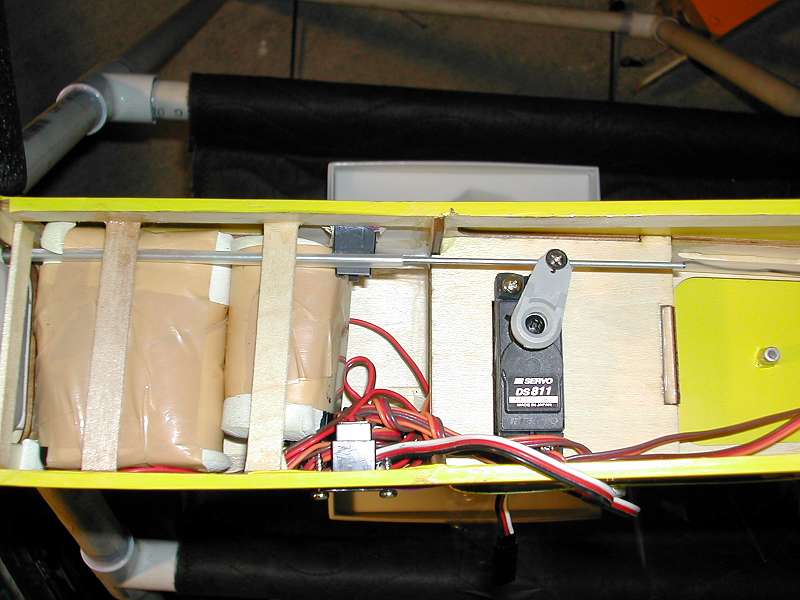

I built my Twist and assisted a buddy with building his... and tripp3d is right, they tend to be tail-heavy. With the big 91 up front and the battery/receiver in the logical locations in the fuse, the balance is within specs (albeit towards the front-most CG setting). Moving the pack behind the throttle servo puts the CG at the rear of the recommended range, which is where I like it. Certainly a smaller or lighter motor would result in a tail-heavy situation, but some folks have reported that the plane flies well even with a CG rear of the recommended range (in the 6+ inches from TE area) but I'm not brave enough to try it yet.
If you already have a Saito 82, I'd agree wtih tukkus and go with it for sure. You mentioned this will be a "3d trainer".. you really WANT the extra power when learning 3D since it gives you extra insurance to pull out of manuevers that don't go well (like hovering). If you have to worry about pull, you will be less likely to push the envelope and learn new maneuvers. I say this from experience, as the Twist has been my 3D trainer... even though I'm still learning how to hover/torque roll, I feel comfortable trying it at low altitude because I know my motor will pull me out and away since I'm already hanging the prop at less than half throttle.

I did have to use a Dave Brown mount, and just skim the edges of the mount on a grinder lightly to flatten the rounded sides a bit. Other than that, redrill the firewall and go. Awesome power. Idles low. These Magnums... I like them. I have 3 now.

If you going to get a Saito82, which is fine, although way too much power, you definetly don't need a vibration mount. Break in your Saito in the air. Perhaps, run one tank thru on the ground with the factory settings and then go flying. The only thing you need to adjust is the low end. Otherwise you will not get a reliable idle on the ground. Use a 14x4W APC and fly half throttle, at the most. You'll find out really quick, how much power you'll have. Good luck and have fun!

macguyver77, In reply to you asking if you could install a larger fuel tank to add nose weight is a bad idea. If you run low on fuel, you are still tail heavy. Balance where recommended, then adjust after you fly if needed.
