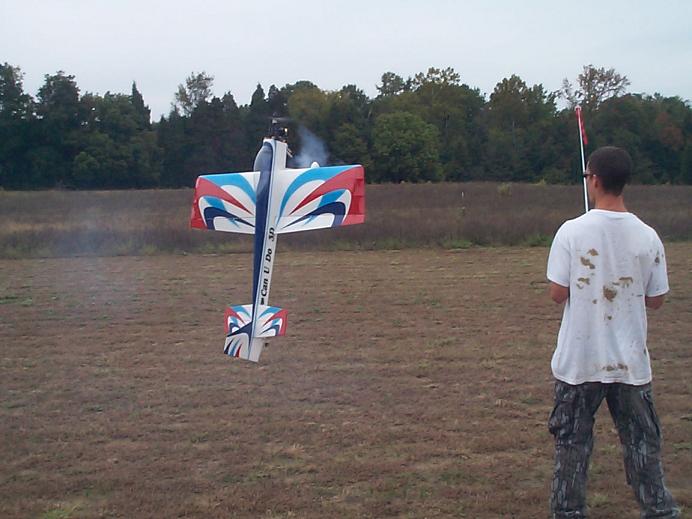

i ahve a saito 120 in mine, this is a pic of teh 3rd flight, cowl was mounted tonight. the plane flys great and 3ds fine. and it will sit still on the runway( in grass) gp says that it won't w/ a 120. i like the way it flys.
thx
chris
