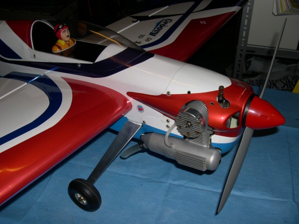

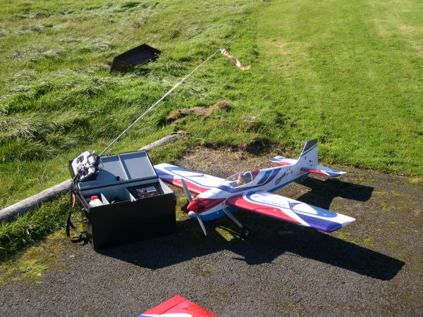

Well now I have built and flown the Groovy50-3D, and must say it flies great, BUT it is not a 3D-plane. Too heavy.
Mine came up with 2,9 Kg. - the specifications says 2,6 Kg.
Maybe it is because I'm using a OS61SF (two stroke) engine witch weights 700 gr. incl. muffler, who knows?
The quality of the kit is good, and assembly is easy.
Here is some pic's of my Groovy50-3D:

Man, you did some serious surgery to get that engine in the cowl. I think you did a great job and I know there's no way in he11 that I'll be able to do it that well. I wish I could send you mine when it get in to have it cut for my SK-80. Was it difficult?
I wonder if I mounted it inverted if it would be any easier. Perhaps I should get a pitts-style or Macs pipe. Any input from anyone on engine mounting and muffler choice?

Hi Warner
Thanks for the comment's, and yes it was a bit difficult. It took me around 7-8 hour's to do.
If the engine was mounted inverted, it would be much easier to do. But I was worried about liquid locking, so therefore I mounted it horizontal.
Good luck with your SK-80 cowl!

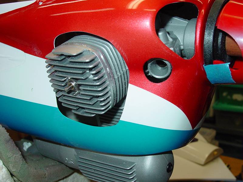

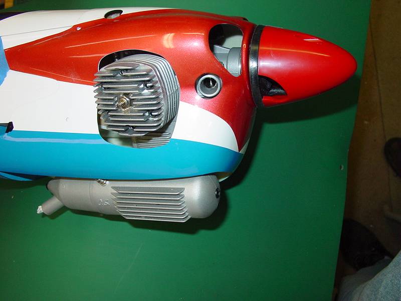

This may be a bit old, but I didn't have a YS 63 lying around so I stole an OS 61 from a twin and tried to see if it would fit in the cowl.
I also kept the engine as far back as sensible to help with the CG later on. Although the airplane is billed as a 52-70 4-c ship the cowl and firewall do allow a 2-c to be grafted onto the front.
I rotated the engine until the std mffler was centered below the fuselage. I considered the inverted option but it put the carb too low for the available tank position. With the muffler at the bottom the cowl could be opened up to both clear the muffler and allow a ton of air to exit the cowl.
The canted engine took out less cowl material and the head tucked in reasonably well.
To do all of the positioning I bolted the engine onto the supplied mounts first. Then the whole assembly could be moved around until the desired bolt pattern could be established for the rear of the mount. The clear plastic cowl "tool" made it very easy to find and cut the openings.
I put a temporary balsa plug in the tank-hole in the fire wall to draw reference lines for the center of the engine. Then I drew new "center" lines to match the angle selected for the cant of the engine. The supplied engine mount just made it inside the cowl. The metric blind nuts were removed and replaced with new 6-32 nuts and bolts.
