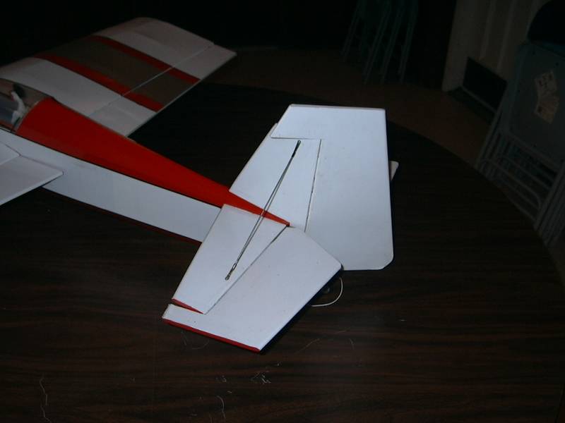

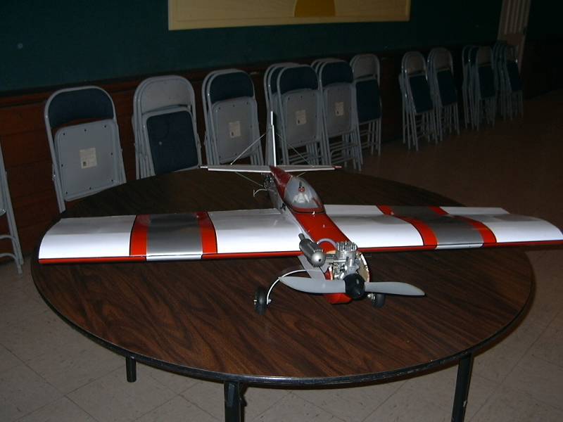

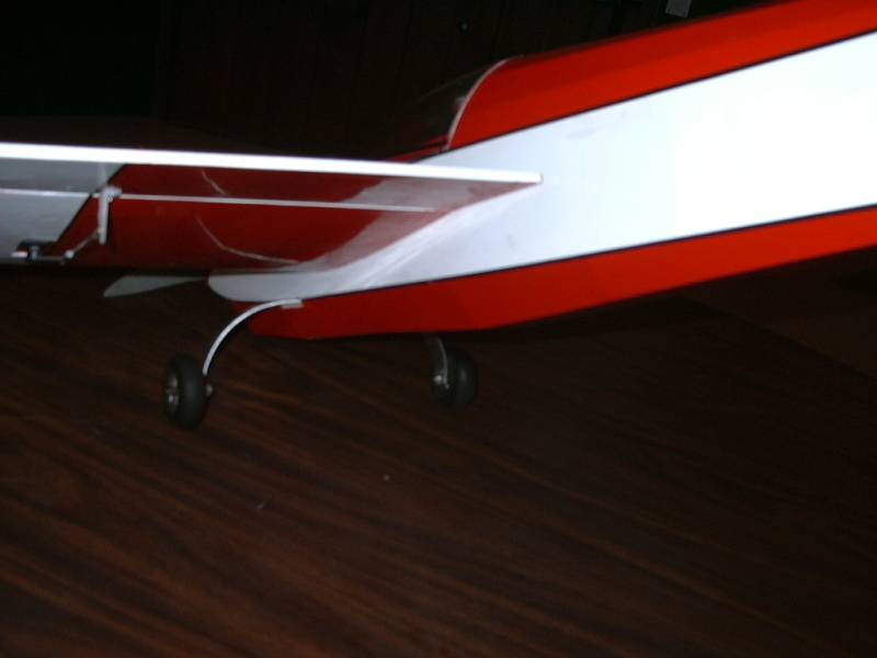

3D is pretty good, but if you want a hardcore 3D plane, build a profile. After flying that and then flying my modified Somethin' Extra, I just love the Somethin' Extreme so much more. it really grooves on low rates, has no roll coupling, and 3D's as well as anything. It's not as stable in a harrier as the, err, Harrier is, but I can gladly ignore that because it does everything else so great. Here's a pic. It's just a Somethin Extra with 3/4" added to the ailerons, 3/4" added to the rudder with a balance tab, and the hinge line moved forward, the notch widened, and balance tabs added to the elevator. I also built a second turtledeck on the bottom to help with KE, but I don't think it has much effect. It needs taller gear, but that can be remedied.

Were there any negative handling issues with the removal of the wing tips? I like the way mine flies as it is, but if whacking off the tips makes KE better, I'll be getting out the saw. What did you do with the ailerons? Whack them too? I had a somethin extra that was modded similar to yours, but no way would it 3D like this one. I think the cg was too far fwd on it to get it past stall, but it did an excellent knife edge. It was my favorite plane at the time of its demise.[&o]

My SE does everything that the Harrier does but smoother. The roll axis is much more stable.
