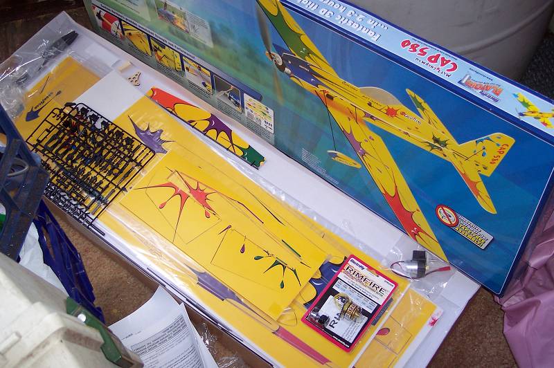

i have cap 580 but hiding it from wife still have to build
