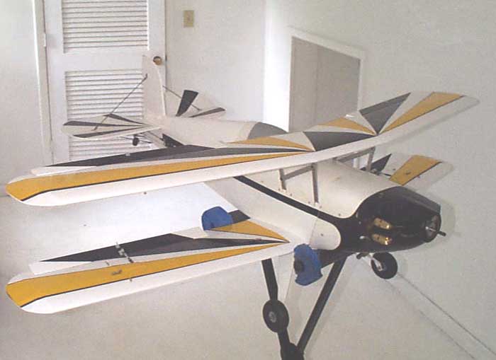

Default A pic
Here she is...

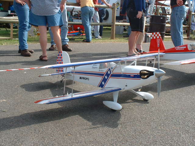

Picture of my CG Bucker from the last air show.

I'm planning on this combo myself and found this review with some recommendation on changing the landing gear to help with the bounce problem, take a look and see what you think.
http://randybrown5.tripod.com/buckerj.htm
Hope mine turns out as nice as your TD1.

wyo_flyer
Thanks for the compliment
I wouldn't change anything. I had mine build according to the planes and i was going to do the exactly the same changes as mentioned on that review but i found that it wasn't necessary.
The trick to keep it from bouncing is very simple a soon as the mains touch the ground you stop holding the elevator stick, the plane will keep the tail up for i while (like i piper cub) until the speed bleeds off. After that is very easy to land and looks very scale like IMHO
