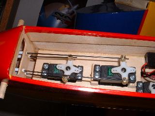

WHat about the servo preferences and possibly different way of mounting?
I planned to use the Hitec HS81MG for the wing and std servo for the rudder/elev.
I read a lot about the flaks on the pull-pull system, and its true that the nylon snap connector is size too big.
Anyone with alternatives?
Old 10-28-2002 | 10:21 PM
Posts: 680
From: OR
Default Planning to get Magic...
As you can see from the attached photo, I used the Hitec HS 225BB servos all around. On noting the oversize keepers for the control rods I simply used some GP screw-lock pushrod connectors. A lot of the guys do not like to use these on flight control surfaces but my experience has been that properly used I have never had a problem with them. This Magic has over a hundred flights on it with nary a problem (stock landing gear, stock pull pull linkage, and rubber band wing hold downs). I assembled it for lightness, Leo .37 engine, mini-servos, and 720 mAH NiMH battery, stock tail skid. Total weight was 3 Lb. 9 Oz.
continuous vertical rolls and hovers are simply not a problem with this little plane. Have fun with yours and keep it light.
Bob C.

Old 10-28-2002 | 11:35 PM
Posts: 990
From: Malaysia, MALAYSIA
Hi Bob,
Thanks for the pic!
