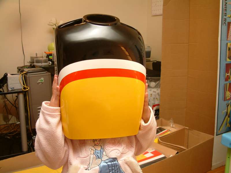

can somebody say RUDDER AUTHORITY
The cowling is beautifully done, and quite robust also

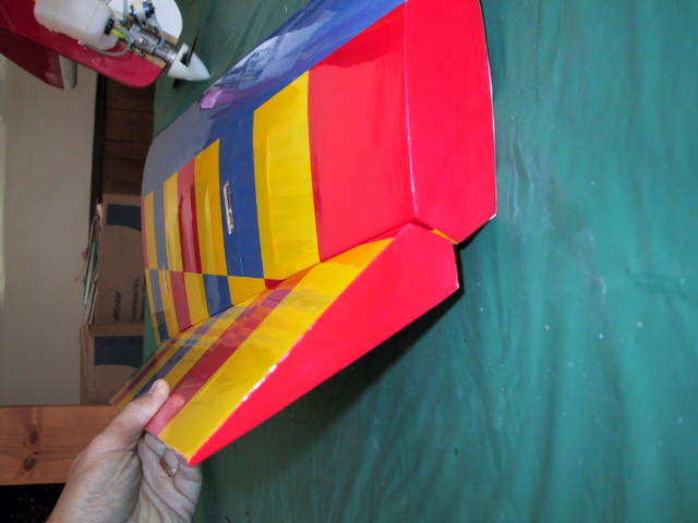

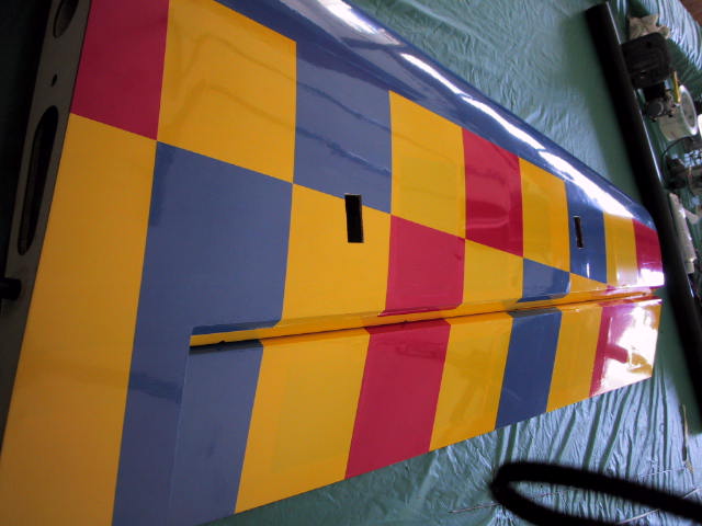

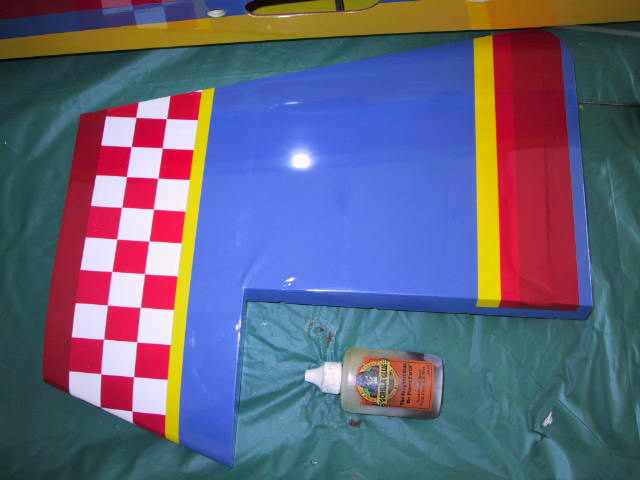

This bird is definitely made for 3D. The elevator and rudder are double beveled, and even though the elevator isn't counter balanced, I think there's enough surface area for good 3D.
I'm definitely going with 2 servos on this one

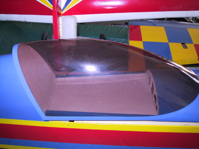

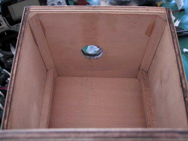

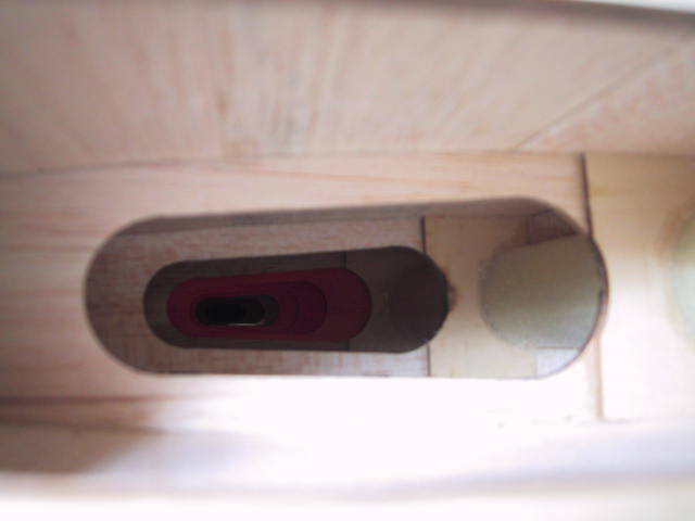

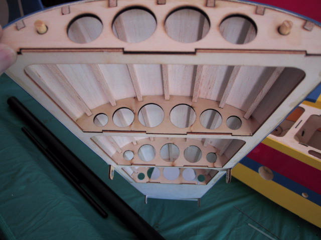

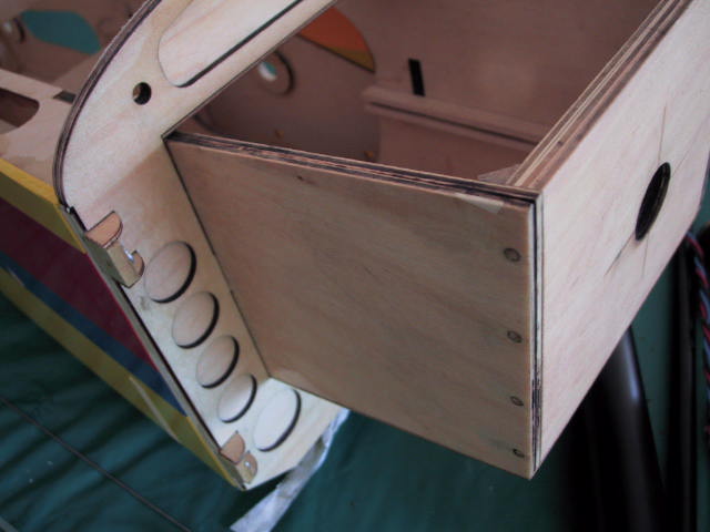

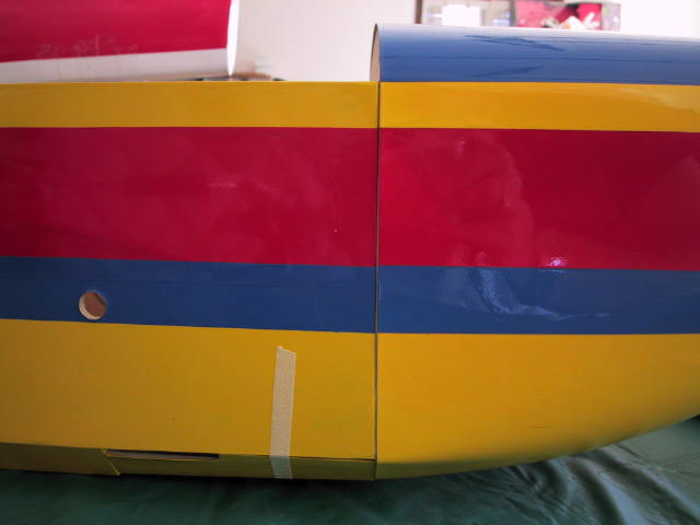

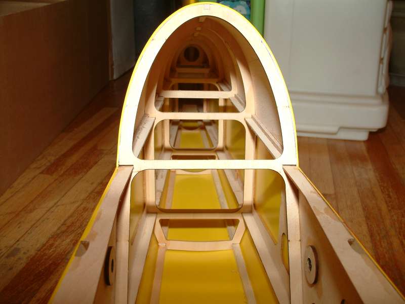

Last pics for the night... the fuselage. It's very lightly built, definitely built to fly, not to crash. You do need to go through every single joints though, as I find that the glue joint near where the hatch is screwed on is loose. All joints are glued with epoxy, not that white glue. The firewall and engine box is doulbe laminated ply as described before, and the firewall box, LG, and wing tube are interconnected, making the structure stronger (see the last pic).
I'll try to get the weight, but it should come close to the Extra posted earlier. This is definitely not your dad's Lanier.

Looks like you got a couple of kids with that airplane. Must have been the deluxe kit.
Cute little buggers.

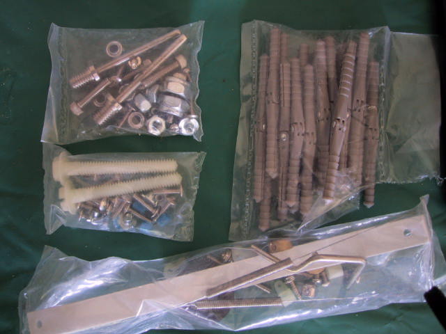

Unless you're really picky, you probably only will have to spend 20-50 dollars in extra hardware. Mainly the clevis that joins the pushrods to the control horn / servo arms, are weak. They may hold up fine, but I don't want to risk it on the elevator and rudder. The ailerons are done exactly stock. The wheels are actually foam, so I might swap it with my H9 wheels. I may keep it just the way it is though because they are lighter.

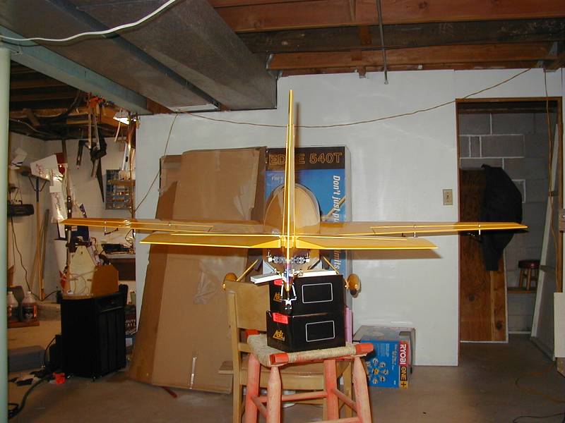

I had that twist in my DPM Edge 27% and was all rev'd up about it. Called Dave Patrick to complain etc. He said to just fly it (of course). So I just flew the heck out of the thing all summer long, you name it I did it. I cannot feel the twist at all. The thumbs just do what they gotta do. Does perfect elevators, harriers are great. Can't tell it's there. Not saying I accept crooked planes, just saying that it didn't make a difference in mine. I was stuck with the plane anyway, didn't seem like DP was going to do anything.
