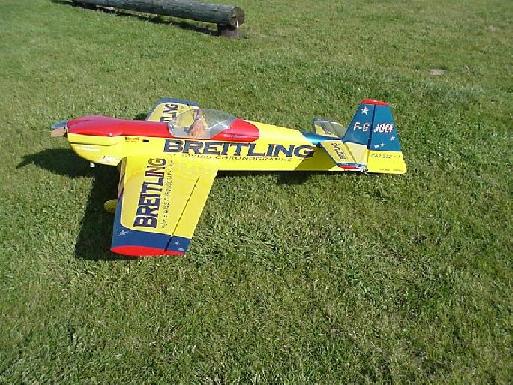

Jbh
is that a cap your flying next to your name. Love to see your videos. Let me know when youve got them running. Off the path a bit but heres pic of my carden cap. Im really wanting a edge pretty bad now. Was just checking out the prices of an aeroworks arf edge 540t. At $ll00 bucks thats not bad. Had my heart set on the 35% carden but the price just went up to $800 for the kit. Im running a 3w100 in my 35%cap
