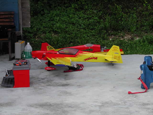

This is my Predator with OS FS 91 SII PUMP, it is fantastic in flight, weight 3.5 kg, servos; 2 HS 545 BB HItec for aileron, 1 HS 645 BB MG for rudder, 1 Hs 81 for torttle, and 1 HS 545 BB for elevator, 5 cells 1470mah SANYO. I have canged the original undercarriage with a carbon MK KATO, the original is very bad!! CIAO Alfo.

Is it plugin og bolt-on wing?
The plane does look marvellous, I've seen it before but the small pics I've seen did definately not do it justice!

I have been thinking about buying one of those as a pattern trainer. How does it perform in pattern type flying?
It sure looks great!

It is wonderfull like trainer for pattern, your profile is NACA 64A014,the proportions are like a F3A, 1.67m x 1.60 m, for me the bst engine for predator is YS 91, because OS FS 91 it is not much powerful one. CIAO ALFO.
