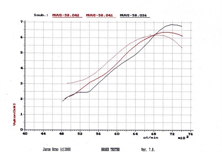

I agree in that the Patty can be balanced with your suggested changes, and I am working in doing so this winter. You are correct in that the ZDZ 50 is "advertised" at 3.37 Lb. " with all flight hardware, Ignition and plug", and Approximately5 HP output. Static thrust /HP "calculated from actual engine data and ThrustHP 2.0 (@ 29.92 in. Hg.)". The ZDZ Super 80 is "advertised" at 4.2 Lb. bare engine, and 8.5 HP, "calculated from actual engine data and ThrustHP 2.0 (@ 29.92 in. Hg.)". No information provided as of type of muffler, and or propeller size.
On the other hand the Evolution 58, which is the exact same engine as the MVVS 58 ( see: http://www.mvvs.com/mvvs/58cc_gasser.html ), "advertised" Weight - 3 lbs 12.7 oz, RPM - 7,000 using a 22x12 prop. My engine actually weight 4.75 with ignition and plug (no muffler). The MVVS factory published dynamometer data showing an output of 6.8 KW ( 9.1 HP), no muffler or prop data. Horizon Hobbies, is more conservative and advertises the 58 output at 8.5 Hp.
As you can see is extremely difficult to navigate through all the manufacturers’ claims of weight and power. They "all" want to make their products (engines, and aircrafts) look as the lighter, most powerful, and with the highest performance. Disregarding the manufacturer’s hype, if we take their data at face value the 58 still looks like the better powerplantvalue for your dollars, even for 75-80 cc class airplanes. This coming IMAC competition season will prove if that’s realistic or not, since there is not much experience with these new engines.

The whole horsepower thing is kindof a misstated voodoo mumbo jumbo too.
The proof is in the pudding so to speak, and that means what prop will it spin at how much RPM's.
Are there any user reports on props and rpms for the 58 that we can make reliable "field observations" from?
Again, the 7000 rpms on a 22x12 does not sound so much more powerful than the DA50's I see spinning 22x8's at 7500 and 23x8's at roughly 7100 or so.
RC Showcase states the ZDZ 60 spinning a 22x10 at 7300... seems like this is what you should expect from a 60cc class engine.
Until someone shows me an EVO/MVVS 58 spinning something like a 26x8 prop, I don't respect it as an "80 class powerhouse" nor do I suspect it would come close in spinning it the same.

I agree with you in that engine manufacturers misstate their specs, and support them with all kind of unrealistic paper calculations, and voodoo mathematics. Even the automotive industry was recently forced to adopt a more realistic standard of calculating HP figures. Until recently the industry measured their engines bare, no accessories, or transmission. The recent adoption of ISO standards has forced them to measure power at the drive shaft.
It would be nice if hobby engines manufacturers standardized their testing and supported their allegations with factual dyno testing, using specific props and muffler combinations. In my experience the most accurate measure of engine performance is how much thrust an engine/prop combination can produce. Evolution states the 58 can turn a 26x10 prop. I doubt that it will turn it more than or even close to 6000 RPM. But we don't know how much thrust it will produce. I also doubt that a ZDZ 60 will turn a 22x10 at 7300 RPM and put out 36.79 Lb. of thrust in the process. Are there any reliable "field observations" to support this claim?
The bottom line is that the "ideal" engine taken wingloading in consideration should provide a considerable difference in thrust to weight ratio. Even an 18 Lb. plane powered 2:1 thrust to weight ratio will fly ballistic. A 10 pound brick powered by 100 Lb. of thrust will fly like a missile (i.e. the F-104, the Saturn rockets, etc.) If a 4.75 Lb. engine can produce over 40 Lb. of thrust, I will consider it as very viable powerplant for up to 33% models. Leo Loudenslager vision in building aerobatic planes was to keep the airframe weight as low as possible and the power as high as the airframe could withstand.
You are correct in that the proof is in the pudding. And there is very little data out there on the Evolution engines. So we will have to wait and see what they really can do in real life.
Remember the old cliché, When it comes down to engine power: Lots is good, more is better, and too much is just enough.

Again back to softwqare calculations. And even measuring thrust with fish scales isn't overly reliable.
So the "constant" is the prop and the measurable variable is RPM.
SO wether a ZDZ will produce 36.79 lbs of STATIC thrust is irrelevant...
If it spins a 22x10 at 7300 (which I do not doubt for one instant) and the 58 Spins the SAME prop about the same... then it raltes the fact the the mystriously powerful 58 is indeed... a 60cc class engine and certainly does NOT provide the equivilent thrust of a ZDZ80 that spins a 4" bigger prop.
Look... we all want the most thrust for the lowest weight (unless you are building a warbird) What I am getting at is that it is evident that people will believe whatever they WANT to in order to complaete the "perfect picture". And while I could very well be wrong... I doubt very seriously that the 58 is anywhere CLOSE the usable power output of a ZDZ80. Meaning down and outright thrust.
If you want a semi-accurate method of comapring, then ThrustHP is a good tool cor comparison... it is completely accurate? Perhaps not, but it stand to reason it calculates everything with the same level of innaccuracy, meaning you can compare the numbers to get an idea of what the differences are between engines.
Horizon's "Benchmark" 24x10 Mens prop at 6900 calculate in ThrustHP as 46.04
RCShowcases stated ZDZ80 (not super) info is 26x10 Mens 6500 rpm and calcs at 56.28
IF these engines spin these props as stated, the it's easy to see that the "Regular 80" is approximately 25% stronger than the 58 regardless of what the real world thrust is.
I've been watching some of the reports of fish scale results and calcing them with Thrust calc... if there is some trend, it apperas real worl "fish scale" pull is about 2/3's of what it calc.
If THAT relates then the 58 will produce real world thrust of about 31 lbs... the 80 about 38...
If you have a 33% plane that weighs say 24 lbs, then you may be dissapointed with 1.3:1 power to weight ratio as compared to 1.6 to one. And if you can have either at very close to the same weight... which do you choose? Which would you consider the better choice for the plane?
But on a 50cc plane that comes in at 16.5 lbs with a DA50 and I KNOW that it spins a 23x8 @ 7150 rpm calcing 41.70lbs... you get about 28 lbs of thrust and a 1.7:1 thrusts to weight ratio.
Where as the same plane with the 58 will be at LEAST 1.5 lbs heavier or 18 lbs with a 1.72:1 thrust to weight ratio.
So again, I ask you... which is the better choice... nearly identical power generated, but the wingloading will be significantly different.
O.K., I've whipped up a good deal of mumbo jumbo here myself.
But again the theory is sound in that what a motor spins a particular prop at is the comparison factor. And until I see verifyable reports of the 58's RPM with what props I can't really make a final judgement... but at this point I take a doubtful view that the 58 is the powerhouse it is reported to be. I think it is a fine 60cc engine putting out approximately what a 60cc should, but being 1.5 lbs heavier than a DA50, and considerably less powerful than a ZDZ80 that it fills a niche where planes do not exist... at this point anyway.
As is the case with this particular aircraft, I can't see why it is rated for 50-80cc engines... they are so in a diffferent league that it's like saying an airframe is a 100cc-150cc airframe.
Ah well... all conjecture and mumbo jumbo... let us know when you get your engine running what it spins and how fast...
