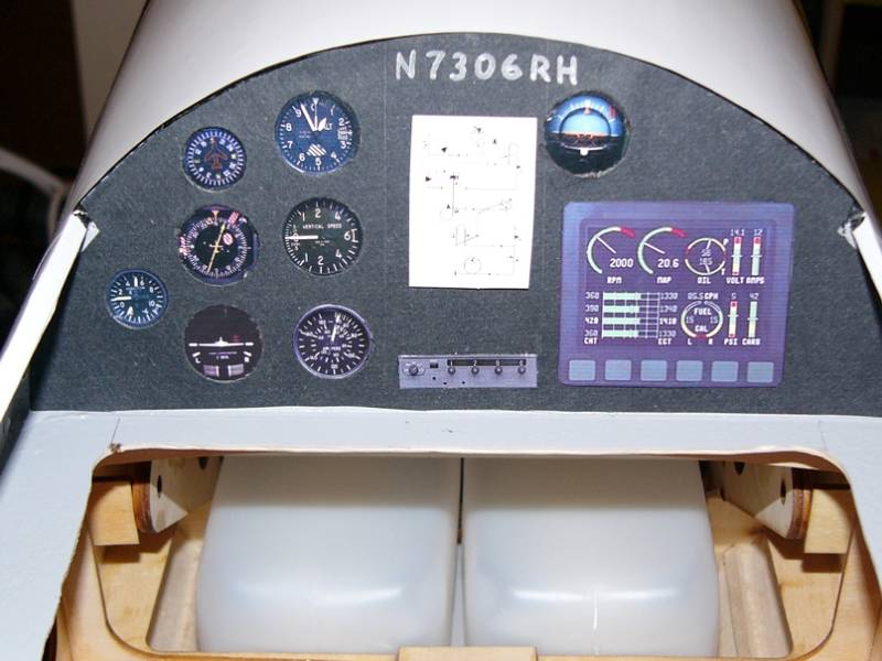

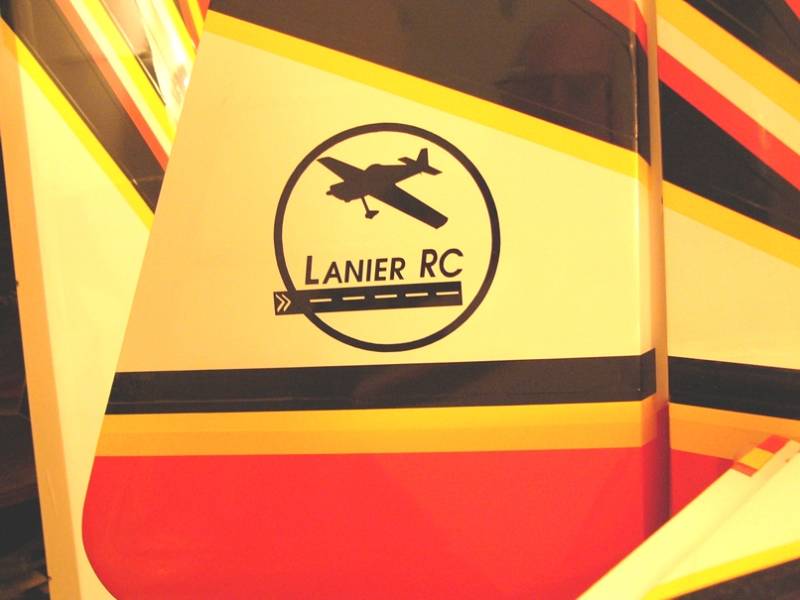

Gentleman,
Here is a picture of the tail with home made Lanier decal, don't like the myler stickers, so this one I cut with my vinyl cutter out of 2 mil premium vinyl.
Also, my instrument panel, weighs almost nothing (about a third ounce). It is made from black construction paper with 3/4" holes punched. I then down loaded pictures of full scale instruments form various sites (Chief Aircraft is a good place). Then printed them on photo paper, cut them out and glued them to the backside. The aerobatic sequence chart is from the IAC shrunk to the appropriate size. You can make the panel look even better by pouring clear paint over the instruments. Since this panel is under a tinted canapoy, it looks ok.
I'm looking at about 20 pounds, maybe a couple ounces short of that. Maudib mentioned a little more weight savings in the front. When I cut off about a 2" x 1" piece on the bottom front of the firewall to make room for the pitts muffler, the removed piece two ounces. Sheeted the area back with 1/8" at almost nothing.
Took about an ounce out of the landing gear plate. Has anybody drilled holes in the landing gear itself?

3dflight,
Nice looking panel!! I am planning to drees up mine with a panel similar to yours. I have photos of the actual full scale Yak 54 which I will like to reproduce.
By the way, noticed your side by side tanks under the panel photo. What size are those?

AirTech,
They are 20 oz DuBro tanks. Had enough room to put 1/4" foam under the tanks and a small piece in between.

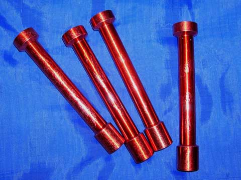

I did get my standoffs today from [link=http://www.forgues-research.com]Forgues Research[/link]
Once again Roger... nice job!
They weigh 5.2 oz and that's pretty good considering how long they are 4.25"... (The stock 2.5" ones are like 3 oz...) When ya gonna start turning titanium Roger?
Maybe I'll get some engine mounting done before the weend...
