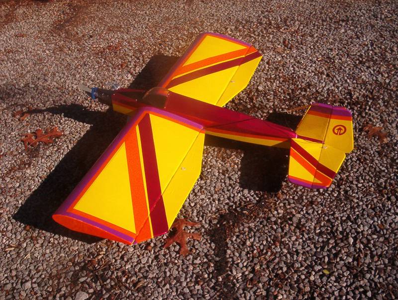

Hi all
Just thought I would post a photo of my uproar before her first flight. She has the added rudder (not shown). now. I am thinking of getting the 60 size and doing all the mods from the start. Maybe an enya 80. O well, here she is. I think I will call her my twistroar.
Freebird

Looks good. I haven't been to the field in a couple weeks so I am glad to hear it flies great. Just like my old flight instructor use to say. " its hard to beat a uproar for the money ". Anyway I hope to be at the Three Star Mall Show In Mcminnville Tn, Saturday 16, 2005. I'll try to bring my uproar.

Ηι freebird1 !
I want to ask you if your Monokote covering in your Uproar is ready and you just iron it.!
Or you buy different colours and you make your sheme?
It just shipped to me an Uproar 40 kit.
So i am looking for colours,and your's i must say it is very beautiful!
