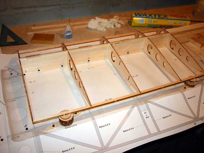

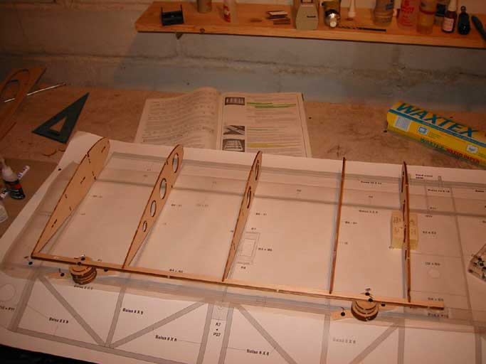

Got the wing webbing in today. Had much multivariable calculus to do, so I only had about 45 mins to work. This is why I won't be done until January! The manual is wrong when it lists the webbing to install, not so much wrong as out of a nice sequential order. I got the inner most wingrib turned right side up too! This is a great kit. I literally think if you dropped the pieces the plane would build itself, but then I'd be bored.
Hopefully more tomorrow. No glue yet either!

Old 11-13-2002 | 04:20 AM
Posts: 166
From: Milford, NJ
Default Laser Models Laser 3D Building Log
hey, did you cut your plan in half?? looks like it in pic...
Crazy Mike
Old 11-13-2002 | 04:24 AM
Joined: Jun 2002
Posts: 366
From: St. Paul, MN
Yes sir. It wouldn't fit on my building board otherwise. Though I didn't think this through to the end, I don't forsee it causing any problems. Of course I kept all structures in tact. Basically, I just cut out the wing.
You're right, not gluing now and gluing later is a GREAT idea!
Reid

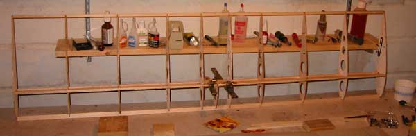

Got some more time to work on the laser. I got the second half of the wing done, and have now joined them with epoxy. No pictures of the second half, it's just like the first one after all.

Then all set up to cure.

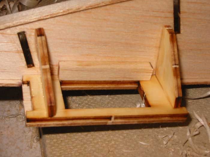

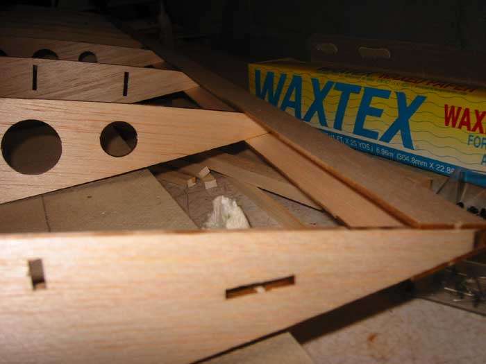

I got this glued in after some head scratching. The plans don't show a gap between this reinforcement and the TE, but the pictures do. However, the only way it fits into the laser cut notches is with a small gap, so I went the parts over the plans. Here it is, this might be a useful reference photo for someone in the future. Kind of boring for the rest of you though.

Old 11-21-2002 | 02:54 AM
Posts: 166
From: Milford, NJ
i got the same gap in mine. just ignored it. when you get to the ailos', you will find that they are firkin' amazingly tedious compared to the rest ofthe kit.

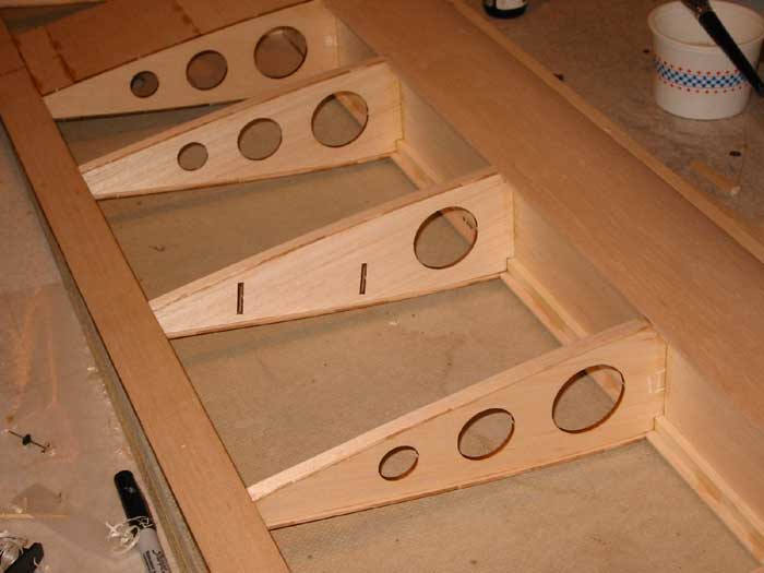

Then I got the leading edges installed. I used alphatic for this, but I wish I had used thick CA. As you can see in the picture the LE 10x10s overhang the base LE by about 2mm. This allows you to pick up the back edge of this block by applying downward pressure on the front. Bad design. They should include some 8x10s or better yet pre shape the LEs! So, using Alphatic gave me too much time. I had a hard time clamping for this reason. Using thick CA, I could have held it together by hand. There's really nothing to line up, just needed pressure against the wing ribs and the laser cut base LE. Something to think about.

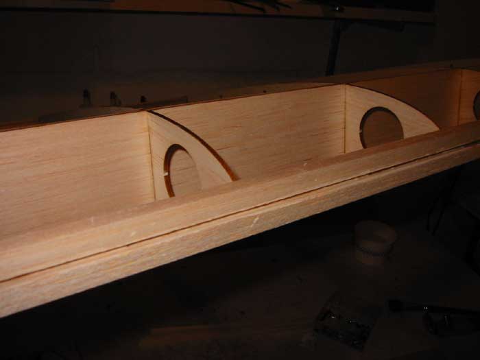

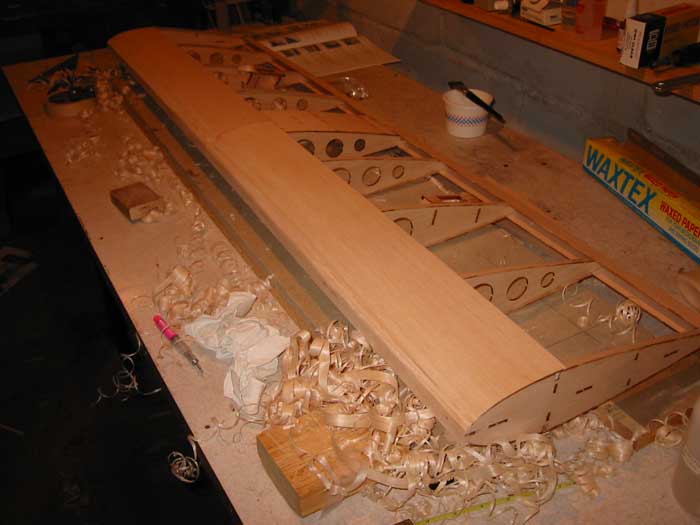

I got the TE Sheeting done today (Saturday) which was nice and quick. It went on nicely, and stuck nicely. The structure didn't really seem to stiffen up alot after the addition of these pieces. It still feels like it has no side to side strength, which is concerning me a little. I think the LE sheeting might help with this. We'll see.

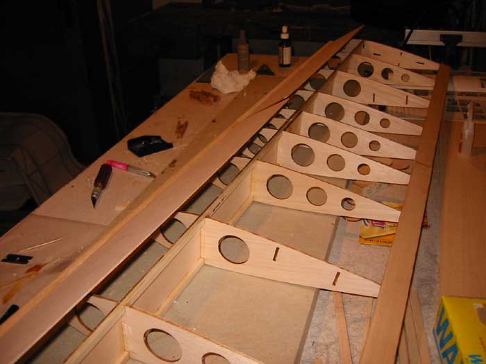

I got the LE Sheeting done today too! Busy day, bad day for flying in MN. Cold and windy. The LE sheeting went on very smoothly. I read a few of the suggestions in Crazy Mike's thread.
http://www.rcuniverse.com/showthread...655&forumid=31
I first sanded the sheeting to a Monokote-able finish and beveled one side with my handy master airscrew razor plane. I then used Thick CA to just attach the sheeting to the leading edge. Once that was cured, I layed thick CA on the wing ribs (the ones to be glued to the already attached LE) and the spar. Then, I took a paintbrush and water and just wetted the sheeting (on the NON glue side of course) until it was damp. Doing this curled the sheeting halfway to where it needed to be on its own. Then, I just layed it down the rest of the way and pinned it in place to dry. This worked out very well, and produced very very tightly fitting joints. Where there were small imperfections in contour etc, I used thin CA just to clean it up. I highly recommend this for future builders!

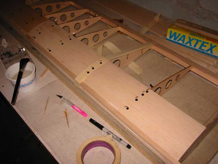

Here's the pic before the rib glue was applied. This picture also shows my biggest error - the upside down wing rib I'll be sure to show the mod that fixes this too..

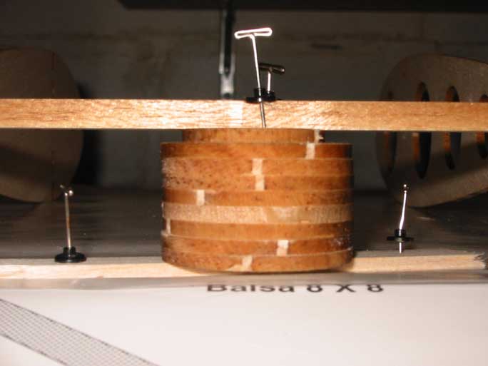

And then the pic of it all pinned up and ready to dry. The tape in this picture is superfluous, it was an earlier attempt to get the sheeting to stay down. Pins work MUCH better. Let me put in another plug for these Rocket City pin clamps too!

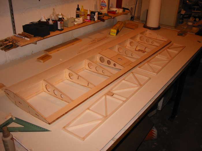

I got the ailerons finished. These went fast! Although I made a few cutting mistakes, so I may run out of the 8x8 sticks included. I might have to run to the hobby shop! No problems. They went together fast and clean.
