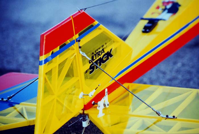

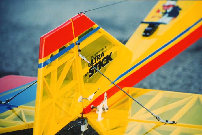

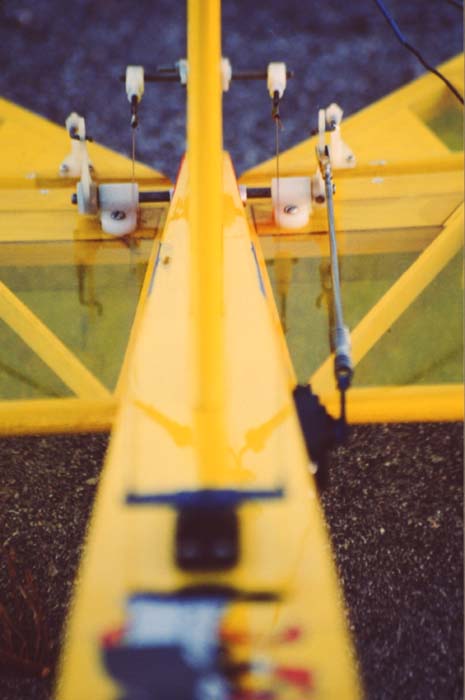

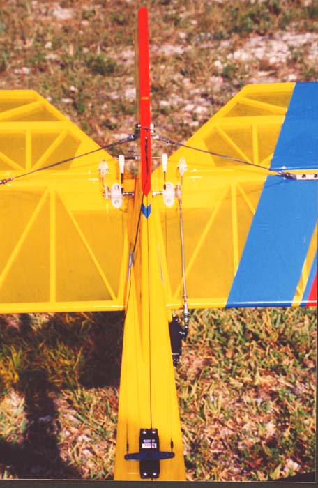

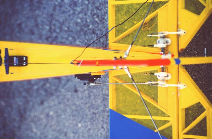

Hi Bobby, sorry about the delayed response, however, I think you might be swingin' too much pitch for 3D. Try maybe a 15x4 on that .91, and go w/ wood if you can't seem to get a few more rpm's. As stated, I've got an APC 16x4W on that 1.20, and it might seem rather small, but it's a heavy prop. And because it's a little under-sized, my engine revs-up RIGHT NOW! (you may need to x-tend your ldg. gear). But first, try to lighten up that plane. As suggested move all equip. back and as promised I've posted several pics of how I went about doing so w/out compromising deflection
Old 11-13-2002 | 01:39 AM
Posts: 608
From: n/a,
Default another shot...
...I've eliminated the piece of hardwood that ties both elev halves together, and to make them swing simultaneously...
Old 11-13-2002 | 01:43 AM
Posts: 608
From: n/a,
Default U-STICK can HOVER
...I've connected a 5/16"Dia rod from one side of the fuse thru to the other side. Nose gear blocks retain the rod...
Old 11-13-2002 | 01:45 AM
Posts: 608
From: n/a,
(just another view)
Old 11-13-2002 | 01:53 AM
Posts: 608
From: n/a,

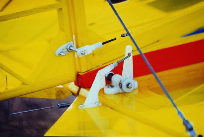

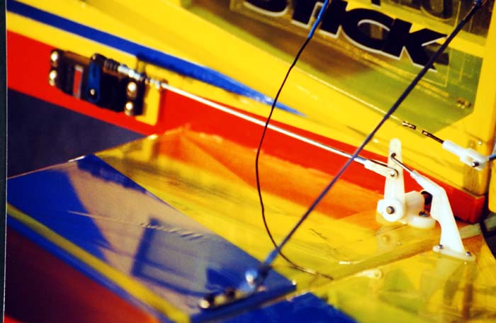

...and nose gear steering arms, on both sides, not only hold the 5/16" rod in place, but also drive the 2-56 rods to the control horns simultaneously. And, the nose gear steering arm on the other side is connected to the servo that drives the entire mechanism w/ a 4-40 rod. IMPORTANT: The 5/16" rod MUST be filed flat at the point where the steering arm set screw makes contact w/ it.

Note how 5/16" rod passes thru hole in fuse. In this view, rudder pull-pull is also visible.

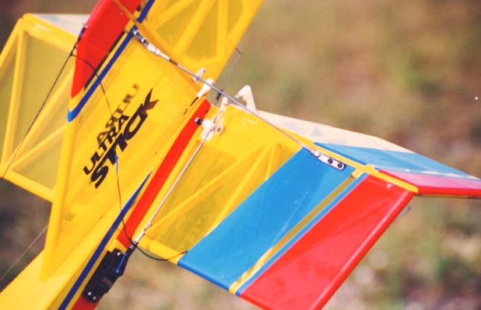

I could've simply added another servo to the other side of the fuse and driven ea. half independently, but this method not only kept the cost down, but most importantly kept down the WEIGHT.
Old 11-13-2002 | 02:14 AM
Posts: 608
From: n/a,
Default IF...

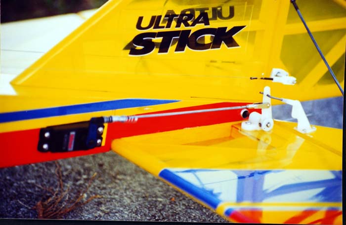

...you decide not to remove the hardwood stick that ties the elevator halves together (which by the way would be your lightest option) you could simply mount the servo aft on the fuse, and use a 4-40 rod from servo arm to horn. However, as you may notice, that elev.stick binds w/ the tailwheel wire when deflected and that is why I chose to remove it all together. Notice deflection...

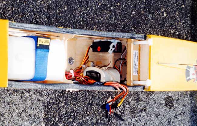

...you can see the beefed-up area on the horiz-stb (hardwood), required for the nosegear blocks. Note battery also located aft.

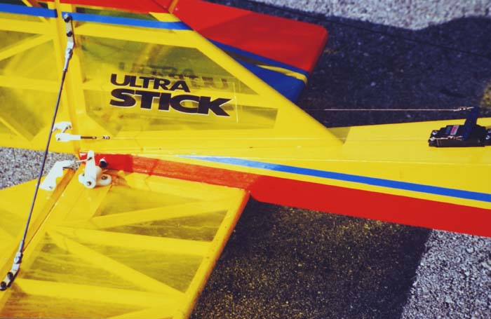

I also enlarged the control surfaces. Enlarged elevator halves...

...and rudder, by using the supplied ailerons for the "non-crow" version, as extentions. lots of control area & deflection :devious:

I've eliminated the servo tray (for obvious reasons) and mounted the throtle servo behind the CG as well, leaving nothing ahead of the CG but half the fuel tank and the engine.
