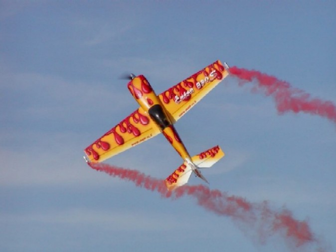

While I was at the TOC i was amazed at how the tip smoke of Roland Matt looked. Does any one have any Idea of the system he used. I have a Carden 330 coming and would like to make that a option on it. Thanks

a pic

I'd love to know what this thing is......

Man is that cool looking or what!! Im sure its a one time smoke bomb. Dont know where to get them but im sure there $$$$.

That looks like a smoke firework ignited by a rocket motor igniter. That just gave me an idea, I have some piccolopetes with green smoke.

I emailed Roland and his response was that they ere not commercially available. There is rumour than hobby lobby will be importing a 3 or 4 minute duration equivalent in the very near future.

I was going to mount it on my wingtip simply with a hose clamp at the leading edge, with a simple rocket motor igniter stuck in the back. I still have 4 of the orange 4 minute ones. They make a good bit of smoke and are real light.

ok, I dont think its practical so get them from tower hobbies as the post would be too much for a few minutes of smoke, but I have smoke pellets that when burnt give off a good burst of smoke, but the problem is lighting them once in the air, the tower hobbies ones have a fuse so you light it fly and thats it, but I wanted to ignite it in the air and use a short burst during a particular maneouver and then be able to put new pellets in a go again. I have machined a cylinder to hold everything, but its just a case of what to use to light it, an electric charge is the way to go, probably on Ni-crome wire if it will get hot enough, I dont really want any naked flames or detonators to ignite the smoke, as this would be easily done but far too dangerous!

You culd put an old glowplug on the fuse and the put a 1,2 volt battery on it and an micro switch with a servo.

I used the ones from Tower before on my old Balsa USA Smoothie.. You do have to light the fuse with a lighter, but other than that they work really well, and the smoke is SOOOO Dense!!!

DanP. is on the right track.I have used those fuses in model rocketry.You take your fingernail and scratch the end exposing some of the powder.Then they light VERY easy.
I taped a wire to the fuse and attatched leads to the other ends of the wire.You know where I'm going with this.An electrical current from two AA's heated the wire hot enough to light the fuse.
Since the Rx doesn't send enough of a current to heat the wire enough,a micro servo between a battery and fuse could make the connection.
Easy do for in-flight ignition.

what I did that works well is to use a 2 amp speed control, plugged in to channel 5 or any open one that you can assign to..
hook the speed control and a small battery to it, and it ramps up the voltage fine..
