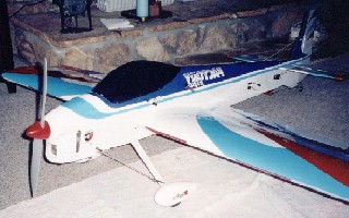

Default landing gear wire reinforcments
used flying wire and extra fiberglass on the inside.

Default Re: landing gear wire reinforcments
Good looking plane, but I would *****can that red factory spinner. Those things are a menace. Especially on 4 strokes. But from the look of your name I'd guess your running a 2 stroker
