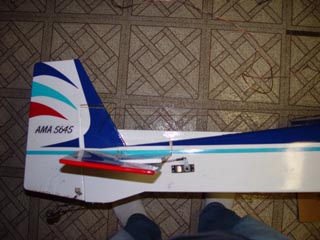

I Just took the wingtips off last week, I flew it Friday for the first time without the tips and I liked the spins better, but I couldn't see any other difference with the tips off. wing rock in the elevators and harriers was about the same as with the tips on.
I've got the CG back at 6", I'll be moving it back a bit more.
The other mod I've made is I've added a strake just forward of the fin. I'm hoping this will improve the pitch to the belly with rudder input. Here's a picture of the mod:
