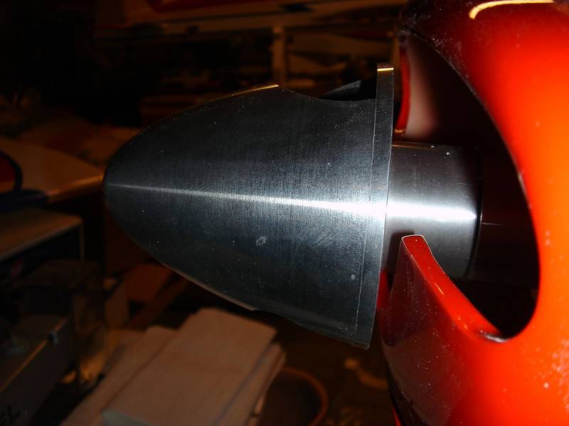

Continuing report on this Lanier Extra 300 project.
I just mounted the engine exactly as detailed in the instructions, using Desert Aircraft 2.5' standoffs.
The template I printed off some PDF file was not exactly up to scale and I ended up transcribing the wrong placements for the mounting holes (about 1/4 inwards of where it should have been). I remeasured on the fly and got the engine mounted on axis without having to mess up the firewall too much.
The engine seems a bit low and I've seen previous comments on the Edge thread that people moved it up about 1/2" even at the price of grinding the engine box to clear the muffler. I will know if this is necessary when I fit the cowl and cut it properly.
Corners inside the engine box got a bit of epoxy runs to add strength. I will also drill a larger hole behind the carburator (when I get to it).

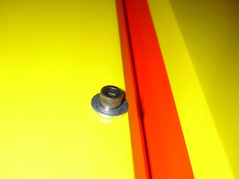

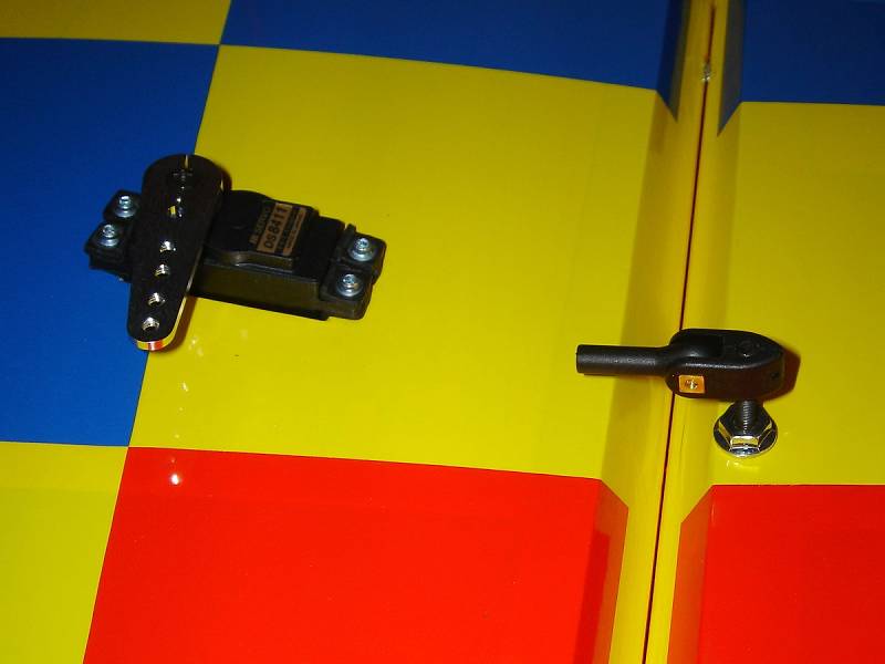

I completed drilling the ailerons and fitting the control horns.
Since the hardware that came with the kit was not an option (too soft), I got both the Hangar 9 solution and the DuBro 913s.
The DuBro screws were a tad too short if I was to mount all the parts included - the aileron being 1.5" thick at the hard points. The Hangar 9 screws were even shorter.
I ended up installing 2.5" socket screws with brass washers, the Hangar 9 nice nuts and the Hangar 9 plastic parts (significantly smaller than the DuBro parts).
The ailerons were hinged with Gorilla glue. First time I'm trying this based on feedback I read on RCU (instead of epoxy). I coated the hinge pins with vaseline, put glue in the holes with a small stick and smeared some on the hinges before inserting them.

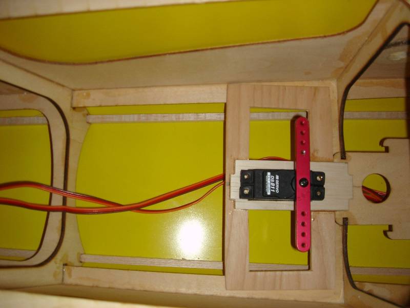

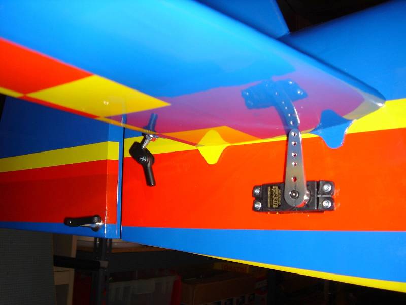

Progress report -
Hinged the tail surfaces and fitted the control horns. Elevator horns are the H9 type. Rudder uses the Dubro 913 setup (the black plastic arms will have to go - they are too big).
Also begun trial fitting the pull-pull setup. once I make the cables, I will move the servo tray to the right position on two beams epoxyed to the side ply. Servo will be the right 8611A and arm will be 4" (3" in the pircture).

I suck. I have been travelling so much, I did not get to this plane much and did not manage to keep some sort of constant progress going. Besides being four times in Europe and Asia since the last post, I also started putting together a QQ 72' Yak that I want to use to get my thumbs back in shape this spring...
I did change the elevator servos to 8611s. I also connected the control rods, using the provided 4-40 from the kit which seemed to be very solid.
I also installed the tail wheel according to the instructions.
I now need to muster the courage to cut the nice covering and link the pull-pull setup with the servo. Another one I dread is the fitting and cutting of the cowl...

OK, definitely run into some trouble.
It seems from looking at the engine in relation to the cowl, with and without spinner that tthe engine is fixed slightly lower than it should be. I think the pictures show that very well - it looks like the engine is lower by at least 1/2 an inch compared to where it should be.
No big deal, I can add some plywood behind the firewall and redrill higher.
The question is, will it affect flight characteristics? Will the engine installed higher on the flight axis, in relation to the stabs and wings incidence line, influence the way the plane flies.
I seem to recall someone earlier had the same issue (perhaps Josh) and raised the engine, only to find out he had to grind the box in order to accommodate the pitts muffler.
To add insult, it seems that the spinner plate is too close to the cowl, a hair from touching it. Rather than insert plywood shims that will eventually crush and compromise the engine mount, I ordered longer standoffs (2.75').
well, whatever it takes...

Hey, Yarom, before you tear everything apart... it looks like Lanier intended the engine to mount exactly as you have it. Have you looked at the image(s) of the Extra on the Lanier website? Looks like the spinner on the one in the picture is in about the same place. Does seem wrong... maybe you should call them before you change it?
As for moving the engine out, just a few washers should do the trick. No need for new standoffs!
By the way, I was the one talking to you at Marymoor yesterday (along with Jason... I was flying the Giant UCanDo). Looking forward to seeing your Extra there this spring!
