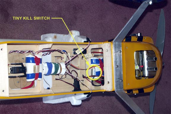

The first time I fired up my new gas engine I shut it down with throttle cut on my transmitter to make a mixture adjustment. The second time I tried to shut it down with throttle cut and throttle trim the engine would not stop running. After that episode I was motivated to install an ignition kill switch that plugs into the receiver and can be operated from my transmitter.
The switch that I used was the RC100 Electronic Switch, Capable of 5 amps at 30V, from rcatsystems.com, $24.95. It's very small, see photo.
