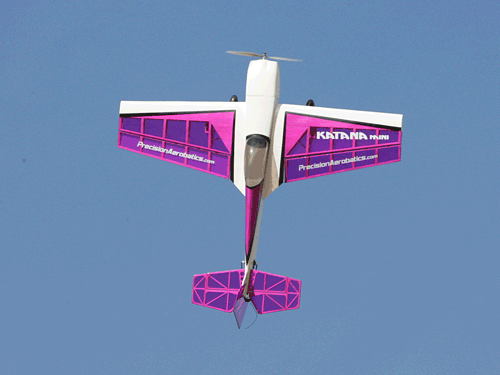

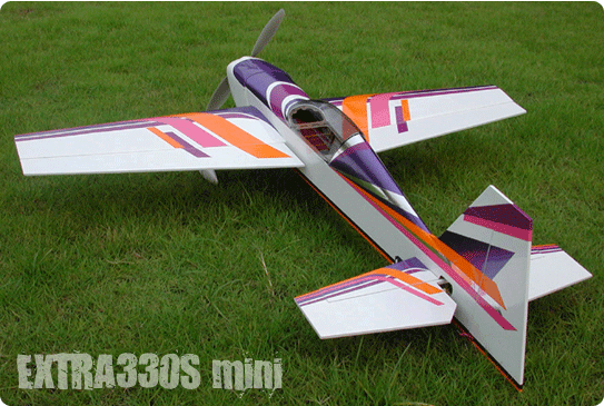

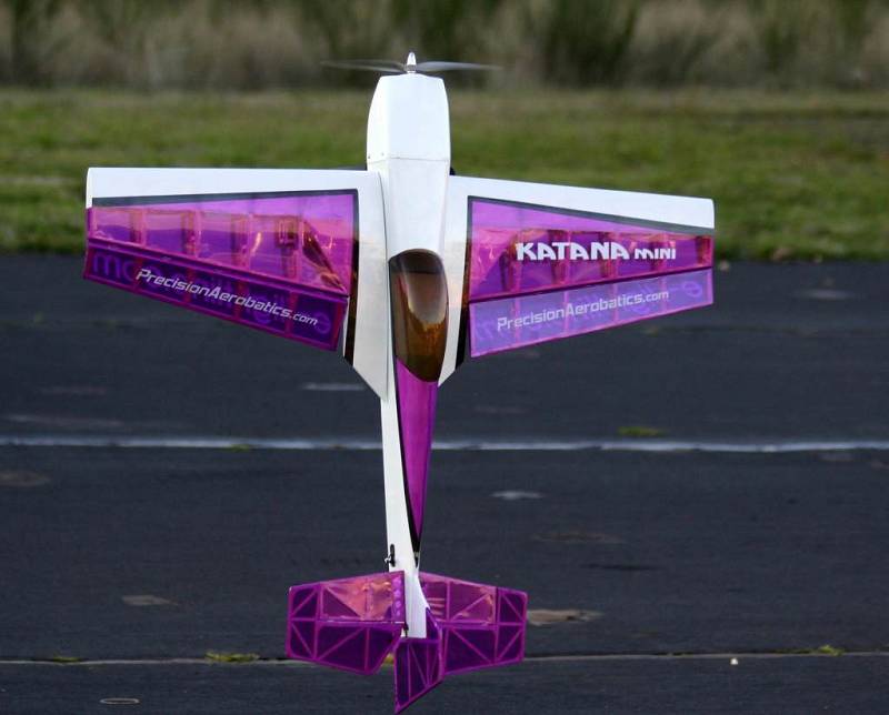

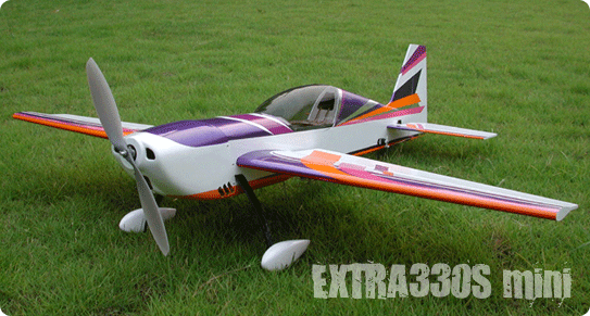

Default mini katana or extra 330 mini
what do you think, mini katana by precision aerobatics or extra 330 mini by fliton
which one is better for 3d
They both look very good
mini katana
Specifications
Wing Span: 40.15" / 1020mm
Length :39" / 990mm
Weight : 370gr/13oz (empty weight)
Wing Area: 375.1 sq. in (2420 sq. cm)
extra 330 mini
Specifications
Wingspan: 980mm (38.58 Inches)
Wing Area: 16.7 sq dm²
Length: 981mm (38.62 Inches)
Flying Weight: 580 ~ 600g (20.45 oz

Both look Hot !! I just received my Kantana Mini. Beautiful kit. The looks of the Kantana are going to be tough to beat. I went with the Kantana because of the carbon fiber built into the plane. I read alot of good things about the Filton as well. Check out this baby. I am on the waiting

I have them both and the Fliton wins hands down!!! It is very neutral-flying (we're talking 1% rudd/ail and 3-4% rudd/elev), harriers, in all forms are the very most rock steady that I have ever experienced, KE authority is outstanding, blenders are absolutely wicked, torquerolls are easy, and stalls are flat. Plus it is just an awesome-looking plane.
However, I still like flying my Katana mini, but it has some wierd habbits. It is however, a superior quality kit, bigger, and has a lighter wingloading. You would be happy with either, but the Katana will be more expensive due to the larger battery and motor. An ideal powerplant for it would be the A30-28, 30 amp esc, and a tp2100 prolite, while the 330 does well with an A20-20L, 20 amp esc, and tp1320 pack.

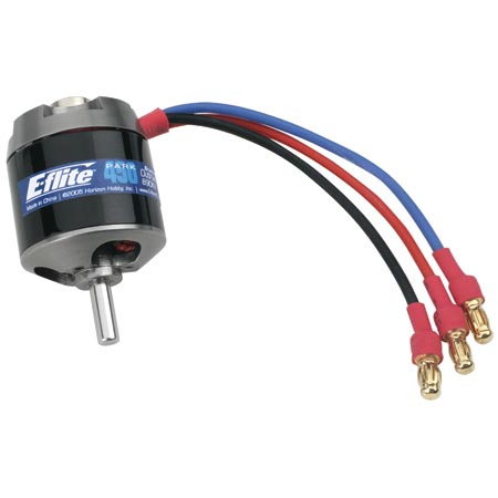

Default RE: mini katana or extra 330 mini
well ,i am still waiting for someone to post a video of the 330 mini extra hovering
i am thinking of e-flite 450 or 480 with 40 amp ESC
what do you think, is it enough for them
PARK 450 BL OUTRUNNER MTR,890KV
Speed Control: 20A Brushless ESC
Maximum Burst Current: 18A for 15 seconds
idle Current (Io): .69A @ 8V
Resistance (Ri): .20 ohm
RPM/Volt (Kv): 890
Recommended Prop Range: 9x6 to 11x3.8 Slow Flyer or 10x5 to 12x6 Electrics
Weight: 2.5 oz (72 g)

Neither are great choices, but the 450 is close to the A20 and the 480 would be overkill.

Katana mini is an exellent plane, however it has very little rudder authority which will give you problems in torque rolls and kinfe edge, It does very nice and stable harrier rolls, harriers are very solid as well.
That being said its super delicate kit, and breaks very easily[] My Mini Edge from e-flight is easily 2x as strong (but has 3 inches less wing span and weighs the same) I would rather have the kit be a little stronger.
The filton flies very well but it has its own set of problems including a stupid little stall that really doens't need to be there. YOu want to have this plane RTF and 19 oz no higher; I would go with a light weight outrunner and a Tp1320 to keep the weight as low as possible on this plane. Unlike the KM, weight is a problem on this plane.

I've got the Fliton. Love it. Outstanding airplane but I'm not about to try and follow Kyle's video. I'll let someone else do that.

What stall is this you speak of? My 330 has no bad stall characteristics and is at least 125% more stable in a harrier than my KM...
Also, mine is 21 ounces and I fly at 6500 feet ASL and the plane feels light as a feather in the air. However, it don't fly too good if you lose power and you pretty much have to point it straight down and just flare and hope for the best when it happens, and forget about getting it back to the runway (ask me how I know). But to be honest, I don't have any electrics that float well without power...

The latest shipment of Mini Katans is supposed to have a larger rudder. I havent checked mine to see if I was lucky enough to get one with the larger rudder...
