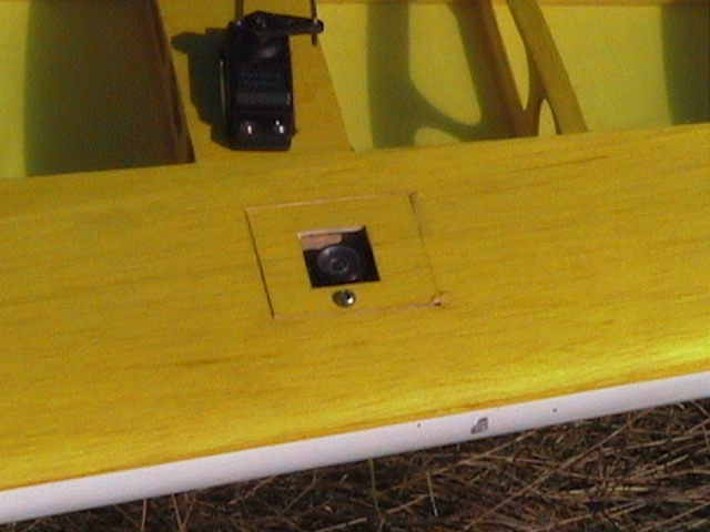

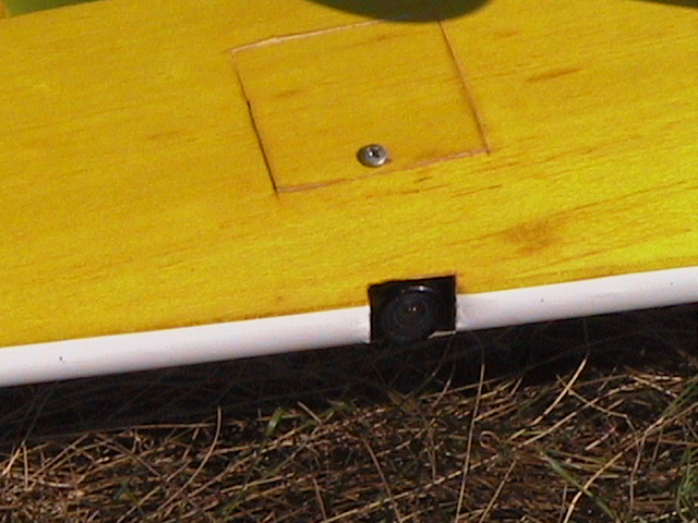

I installed two cameras onboard my Funtana and fly with video goggle. I use goggle from take-off to landing. Last summer I practice aerobatic flight to know what is possible to do using only video to control the planes. The cameras are inside the wings. One camera looking front and one cam looking down. I use the down cam only when flying vertical. The horizon appear in the center of the video when the planes is level(front cam) or the planes is vertical (down cam). I made a video switch plug in the gear channel to change cam while flying.

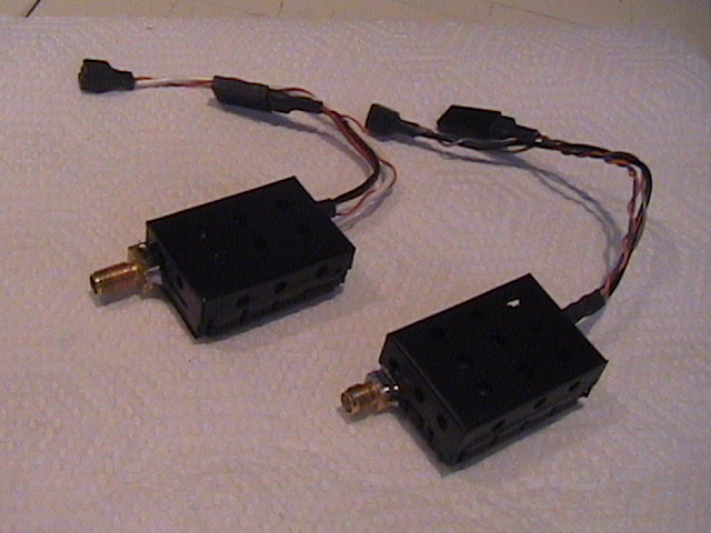

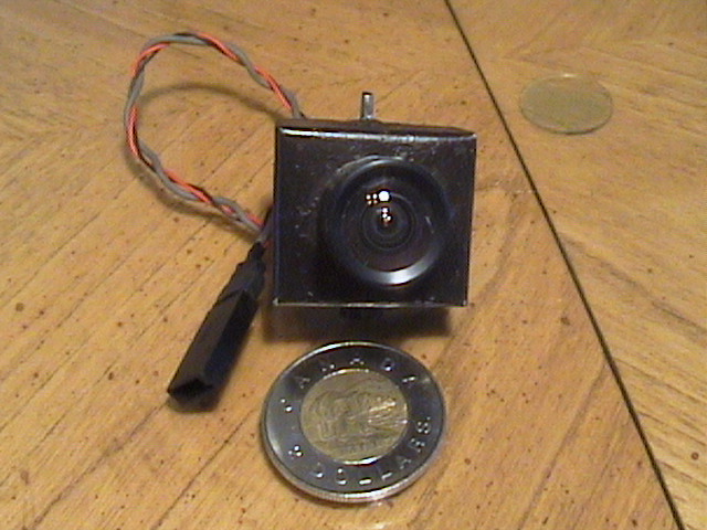

I made my own system. I buy cam from Black Widows, the old CX161 and new KX121, I made a metal case to protect it. Two wide angle lens (105 deg.) are use. For the video TX/RX, I use Felsweb or Airwave module, I had few parts, connector and case.
