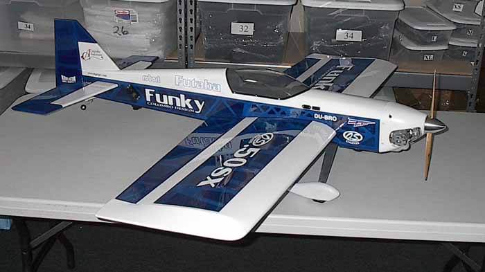

I admit it. I am a slooooow builder. I bought this last year at Joe Nall and have worked off an on (more off than on) since May of last year on it. In my defense, I have completed several other projects in that span. I think this will be a sweet plane when I get her finished. I still have to set up the carbon control rods and install the remaining linkages. All up weight is 4lbs 15ozs ! Power is an OS .50sx with an Ultrathrust muffler. Took a little work to build the tunnel for the Ultrathrust, but I think it will be worth it. Kit was really well enginered. Instructions were a little sparse...Nothing that couldn't be figured out. Thanks to those of you who helped with thrustline placement. Hope to have her in the air by the end of the month. I'll let you know how she performs.

Contempo: Sharp looking plane. I did mine the same except used Trans red. minus decals. After seeing yours,I wish I had used some decals!
I am curious as to your antenna routing. What did you attach it to at the rear end?
I will be installing the receiver in a day or two,and maybe will fly it in the next ten days,if weather permits.
