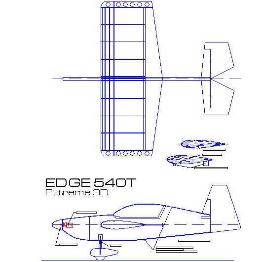

Dave, thanks for sending me the link to your Edge plan. I had already scaled Tim H's Outrageous Foamy Edge 540 to 36' span and I built it today using 3/8" polystyrene foam edged with 1/16 balsa for both the wing and fuse.
It was much lighter than the sturdy board and the bare airframe weighed just over 3 oz. It launched vertically just like George's Tribute but the wing flexed alarmingly during manouvers. I need to stiffen the structure but haven't been able to find any carbon fibre tube in my locality.
Bob
Old 03-05-2003 | 06:34 PM
  #65
Av8er Tim's Avatar
Posts: 98
From: Keller, TX
Default Indoor 3D , Texas Style
Bob - Fancy meeting you over here... Try some 3M Strapping tape. You will be very surprised at the strength it adds. Add 2 tape "spars" top and bottom. One at about 25% chord, and one at 75% chord. Set the wing down on a table, mark the spar locations, cut the tape about 4" longer than what you need. Then pull the tape tight with both hands, lay the tape on the wing, rub it down well. Then do the other tape spar on the same side (ie 2 on top) The core will bow up a bit from the tension of the tape. Don't worry... Turn over the wing and do the same thing on the bottom. The tension on the bottom spars will pull the wing flat again. This method works great and it adds almost no weight. You will be VERY surprised at how strong the bare foam is now. Here is a pic of the Edge 540T he is talking about.
Tim H.

I'll post a link to the Edge 540T plans when I get home tonight. They are free, and in tiled pdf format.
Tim H.
Old 03-05-2003 | 11:04 PM
  #69
Av8er Tim's Avatar
Posts: 98
From: Keller, TX
Here is the link to the Edge 540T 3D plans:
http://www.jetworksmodels.com/videos...0TplansPDF.zip
Here is a link to the building/flying thread:
http://www.rcgroups.com/forums/showt...5&pagenumber=1
Tim H.
