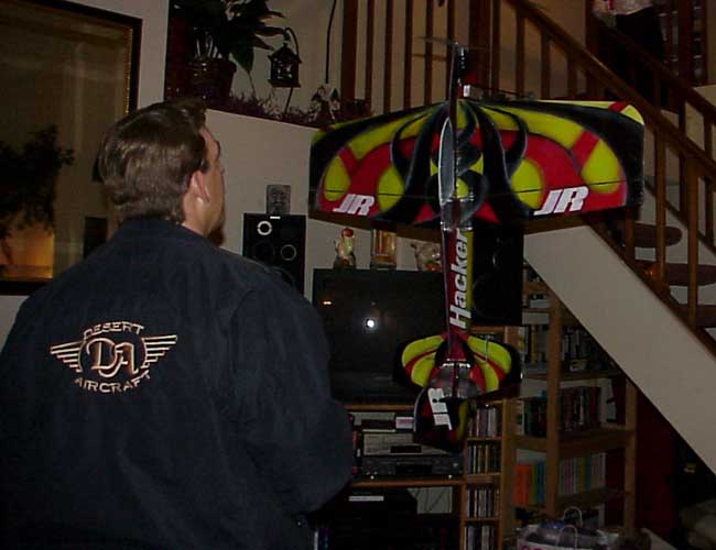

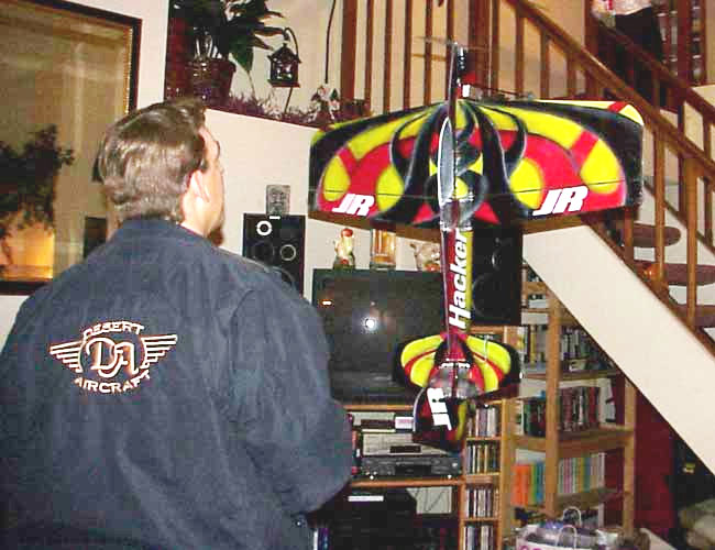

Hi Guys,
I know that this may be more suited for the electric or profile airplane categories but I thought many of you 3D/precision fliers might appreciate the video found through the following link...
http://www.team-rebel.org/GRH_E3D_001_0004.wmv
It's a fairly large file so a fast connection is preferred.
My friend Bill Higgins did an amazing job on the video compilation and I truly think you'll enjoy it.
The airplane is called the Tribute 3D V1.7 and it is designed specifically for the Hacker B20 line of brushless motors. Currently I'm using the Hacker B20 26S with a 4:1 gear reduction, APC 11x4.7 prop and the new PowerfLite Lithium-Polymer batteries. This combination allows 3+ minutes of hovering (T/W >=1) along with 10+ minutes of normal flying. The wingspan is roughly 40" and the empty weight is 10-11 oz.
This is the 7th iteration of the Tribute design and great care was taken to insure that the airplane's performance and handling qualities were up to the standards expected from a seasoned 3D/precision aerobatic pilot.
The airplane was designed to be a 3D trainer for one to learn the basics of 3D flying without the fear of crashing a more expensive model. The thrustline and roll damping were setup to provide a very neutral/damped feel in pitch and yaw while also having enough roll damping to keep the torque roll spinning at a docile rate thus allowing the new 3D pilot more time to think before being forced to make corrections.
We actually went so far as to predict the aerodynamic roll damping as a function of the wing planform shape and balance this damping moment with the motor torque such that the steady state spin rate would be less than or equal to 180 degrees per second. This extra damping allows you to lean the airplane off vertical only a few degrees and prevent the torque roll from ever happening.
It's also capable of fairly steady elevators/harriers and high-aoa rolling circles. The airplane is quite crash resistant and we've yet to destroy an airplane completely. Typical crash damage is quickly repaired with Scotch tape or a new prop. Only once did we render the airplane unflyable when we were flying out a gym door in knife edge and accidentally hit the door frame.
I currently have no plans to kit the airplane because of the hassle, but I expect to see a major hobby distributor bring it, or a variant, to market in the near future.

The airfoil is a 1.75% thick flat plate...the funny and perhaps surprising thing is I wouldn't want it any other way.
When you start looking for airfoil sections for aerobatic aircraft the obvious choice is something of a symmetrical nature simply because you don't bias its force producing capability in a certain direction. When you couple this with low Reynolds number aerodynamics you quickly come to the conclusion that a thin section will be the best from a handling qualities point of view simply because the nondimensional aerodynamic coefficients aren't strong functions of airspeed. (Assuming of course that the size of the airplane is fixed and the kinematic viscosity of air isn't apt to change wildly in the near future).
In other words the airplane's aerodynamics should vary in a linear fashion no matter what speed you're flying.
A good example of this sort of thing is the small balsa hand-launch gliders you can buy at any convenience store. Notice that they have a simple flat (or curved) plate for an airfoil section. Most think that this is done simply because it's cheaper and easier to manufacture but lets suppose that they outfitted their little glider with a standard NACA 4412. If you look at the 2D wind tunnel data you see that the lift curve, drag polar, and pitching moment coefficients vary wildly until you get to a Reynolds (Re) number of greater than 250,000. Actually it only starts to really look good above 3,000,000 which happens to be the Reynolds numbers that it was designed to operate in. If we measure the airspeeds that our little Wal-Mart glider flies at we calculate that it operates from a Re of 10,000-80,000. This assumes that you can throw it at 60mph and it’s trimmed to glide at a min-sink speed of roughly 10 ft/s. Notice that the 12% thick NACA 4412 would be a total disaster in this Re range since the aerodynamics vary so much. Conversely, if you look at the data for flat or curved thin plates you see that the lift curves, polars and pitching moment plots barely change from a Re of 20,000 to 250,000 making it a great choice. In comparison the Tribute operates from roughly 32,000 to 300,000 which also makes it my airfoil section of choice.
The funny thing about aerobatics, especially precision and 3D model aerobatics, is that our pilot opinion, of the airplane’s handling qualities, is governed almost completely by the linearity of the aerodynamics. When we command a certain amount of Tx stick travel we expect a proportional amount of response from the airplane. If this response occurs in a nearly linear manner (or we can setup the curve via exponential or some other mechanism to make it feel linear) the human controller can easily command the model and will often pronounce the handling as good or even exceptional depending on his background and ability.
Simply put “be wise…linearize”
Hope this clears up some of the confusion in the airfoil selection,
George Hicks
Team JR
PS To answer another gentleman’s question, the model is constructed from blue insulation foam.
