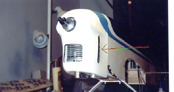

Old 12-13-2002 | 06:33 PM
Joined: Jun 2002
Posts: 123
From: saltillo, MS
Default RCS 1.40 gas on U-CAN-do
test fit
Old 12-13-2002 | 07:00 PM
Joined: Jun 2002
Posts: 123
From: saltillo, MS
Default side veiw
side veiw
Old 12-13-2002 | 07:03 PM
Joined: Jun 2002
Posts: 123
From: saltillo, MS
Default bottom veiw
bottom veiw
Old 12-13-2002 | 07:09 PM
Joined: Jun 2002
Posts: 123
From: saltillo, MS
Default extra vents
i cut out extra vents on sides

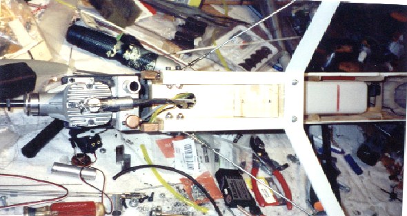

Old 12-13-2002 | 07:11 PM
Joined: Jun 2002
Posts: 123
From: saltillo, MS
Default looking doun on carb and linkage
top veiw
Old 12-14-2002 | 05:22 AM
My Feedback: (11)
Posts: 1,056
From: Smithfield, VA
Default Another UCD3D engine question
supertiger-
how did it balance out??
how much lead in the tail??
are you going to fly it this weekend?
Old 12-14-2002 | 05:41 AM
Joined: Jun 2002
Posts: 123
From: saltillo, MS
Default ballance
Vatechguy, I know your probably sick of hearing this but I'm not finished putting it together. but its not my fault , Im waiting on my third wing from Great Planes, the first one came covered back-wards so they send me a new one to replace it and the new one came UPS and all the wing ribs were broken so I'm still waiting on UPS to bring the third wing.
